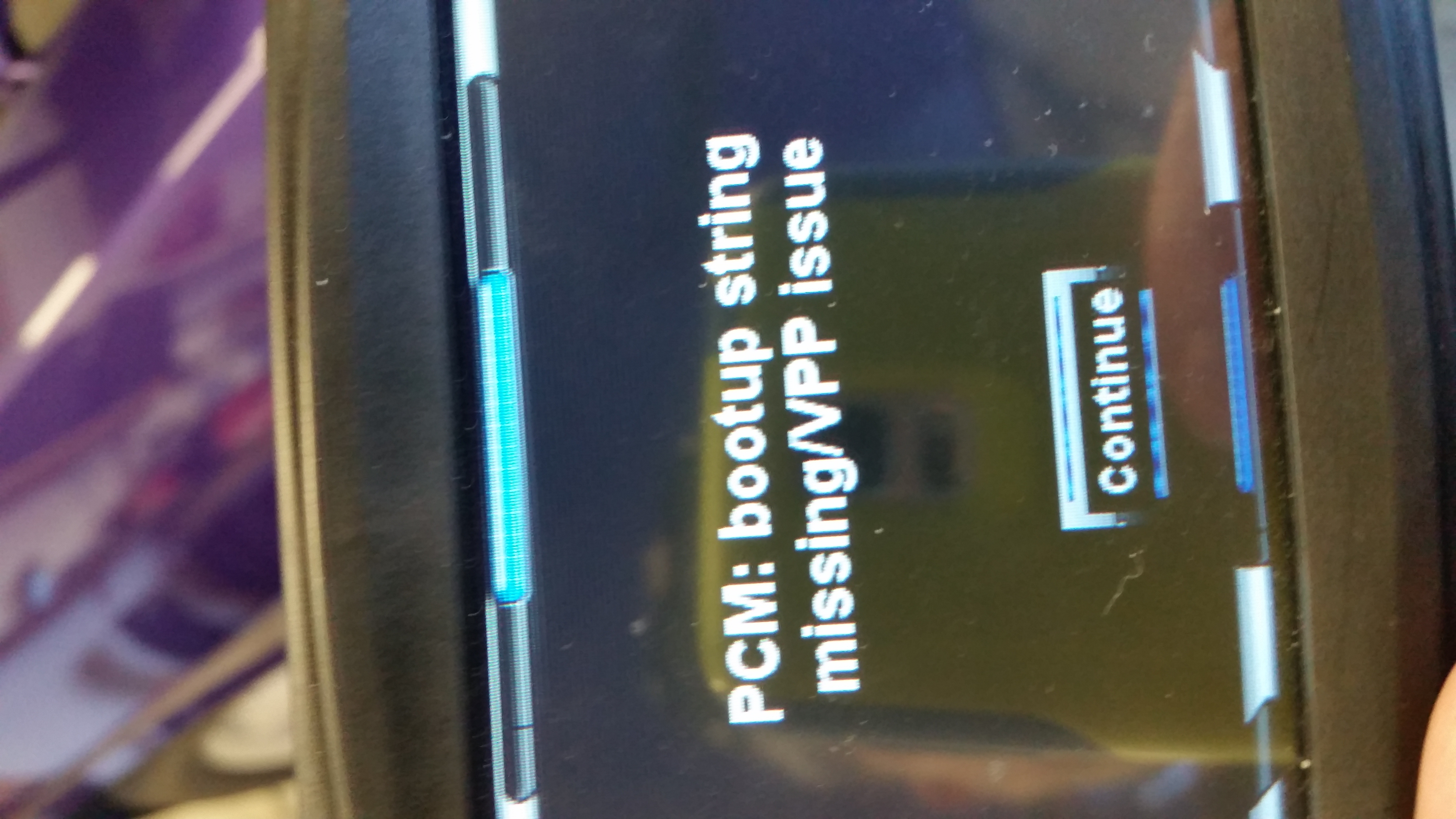

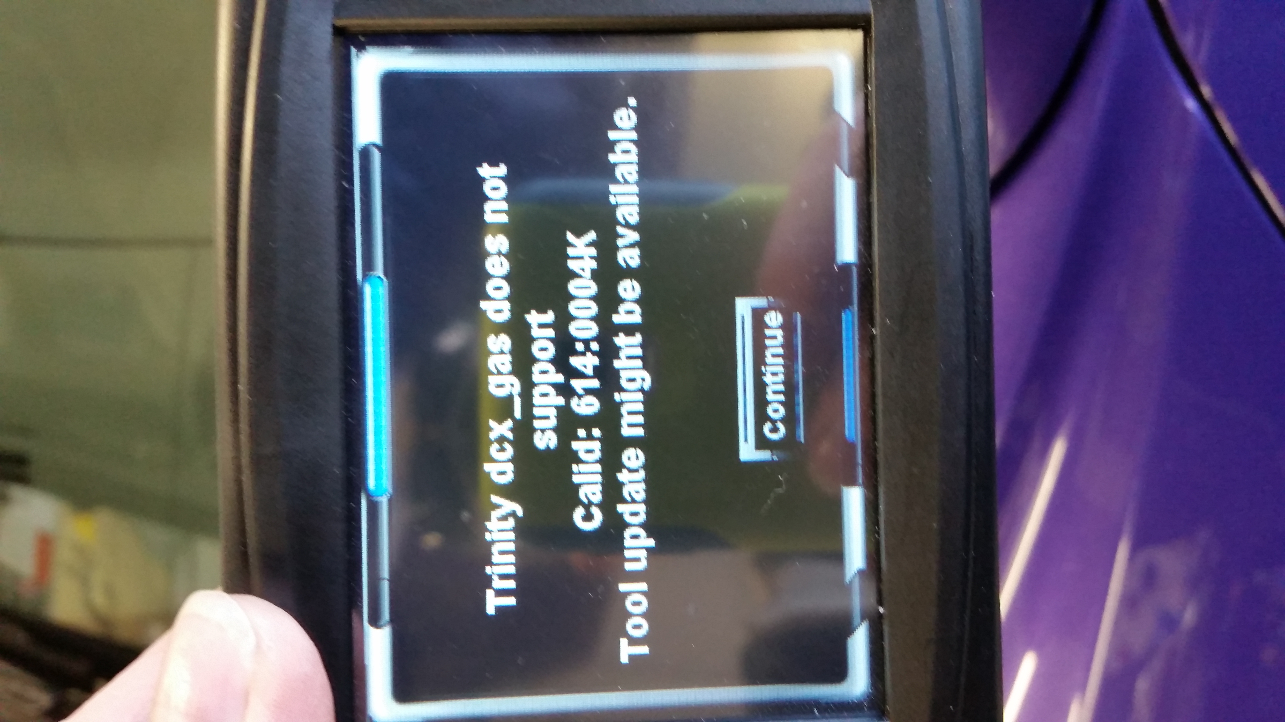

Has anybody had their Diablo trinity cause a ECM failure. PCM: U0100 code came up after trying to restore to factory tune. Now the trinity is just failing to write or read every time.

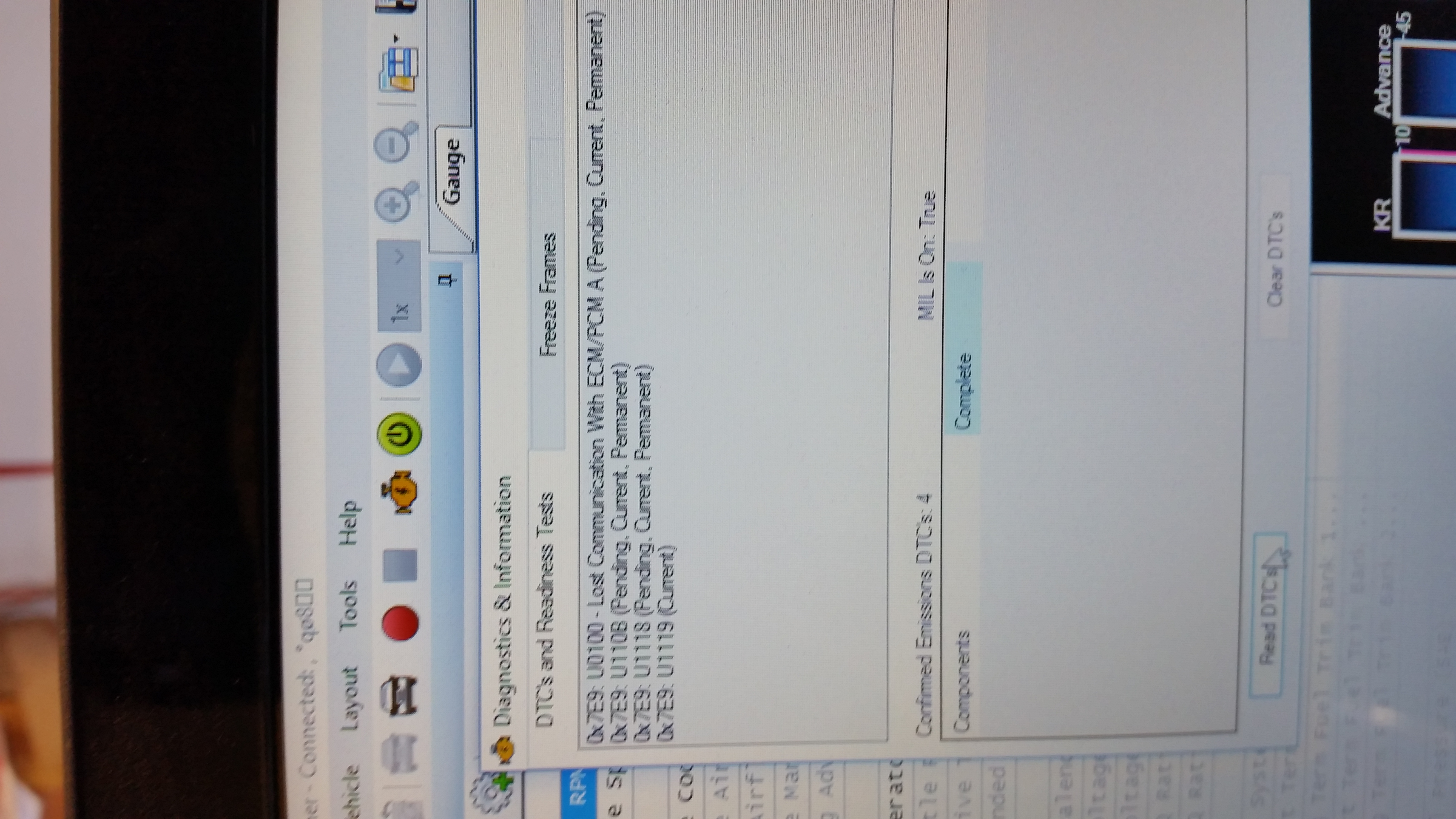

Here are some screen pic's of the codes.
yes I used a friends HP tuning to get the codes out of the car.
0x7E8: P1697 (Pending, Current)
0x7E8: U0141 - Lost Communication With Body Control Module A (Pending, Current)
0x7E8: U110C (Pending)
0x7E8: U110E (Pending)
0x7E8: U110F (Pending)
0x7E8: U1403 (Pending)
0x7E8: U1411 (Pending)
0x7E9: U0100 - Lost Communication With ECM/PCM A (Pending, Permanent)
0x7E9: U0103 - Lost Communication With Gear Shift Module (Pending)
0x7E9: U110B (Pending, Permanent)
0x7E9: U1118 (Pending, Current, Permanent)
0x7E9: U1119 (Pending, Current, Permanent)
So any information would helpful
DTC codes first pull
not supported
not supported
bootup string missing

I have not seen this, so I am watching this thread.
Almost sounds like the program was interrupted.
I am curious if a recovery is possible.
VIN not stored and multiple comm errors may indicate a solution may be available.
Good luck.
