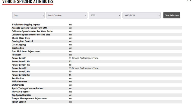

Sorry to bump this old thread ,
I bought intune i3 platinum and i love it , but im kinda bummed and i feel a bit misled (i probably should've asked before i bought it ) , that i cant control the hydralic cooling fan , also transmission options are missing from the tuner , but i feel a diference in shifting .
On the official site its said that the device supports those options for the specific model ( jeep wk 2005-2010) but in reality it does not

Re: Jeep grand cherokee 2007 fan control
attachedmikel wrote: Thu Jun 20, 2024 10:31 amcan you post the info.xml file from your i3 drive?Madnesst wrote: Wed Jun 19, 2024 1:27 pm Sorry to bump this old thread ,
- info.xml
- (3.09 KiB) Downloaded 76 times
