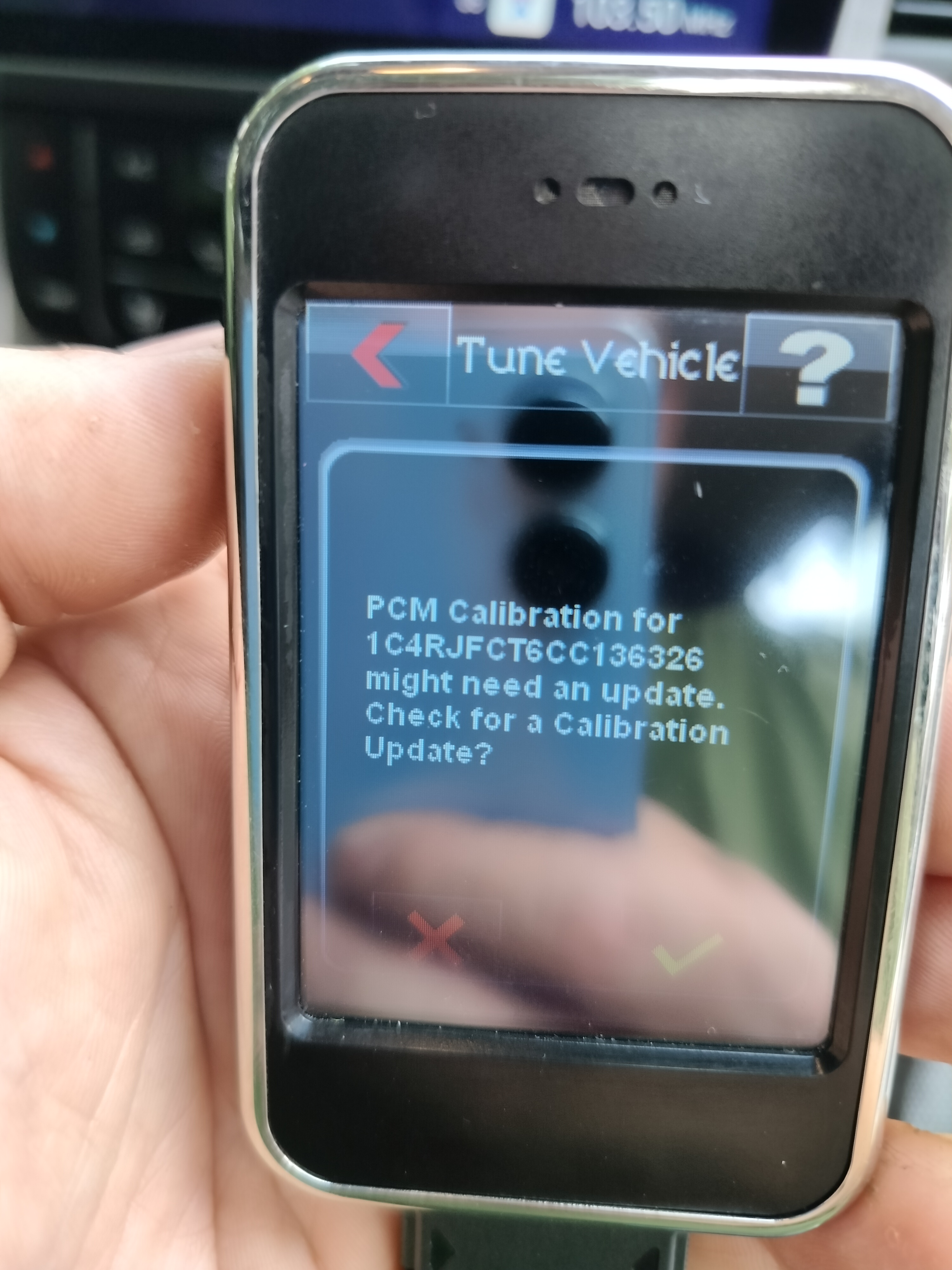

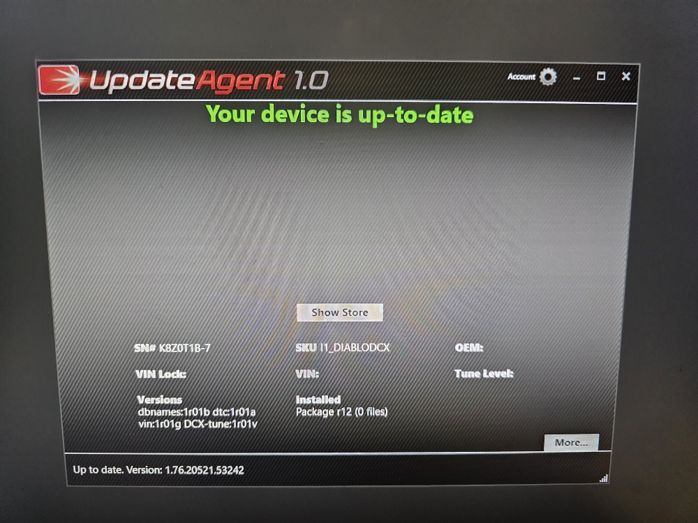

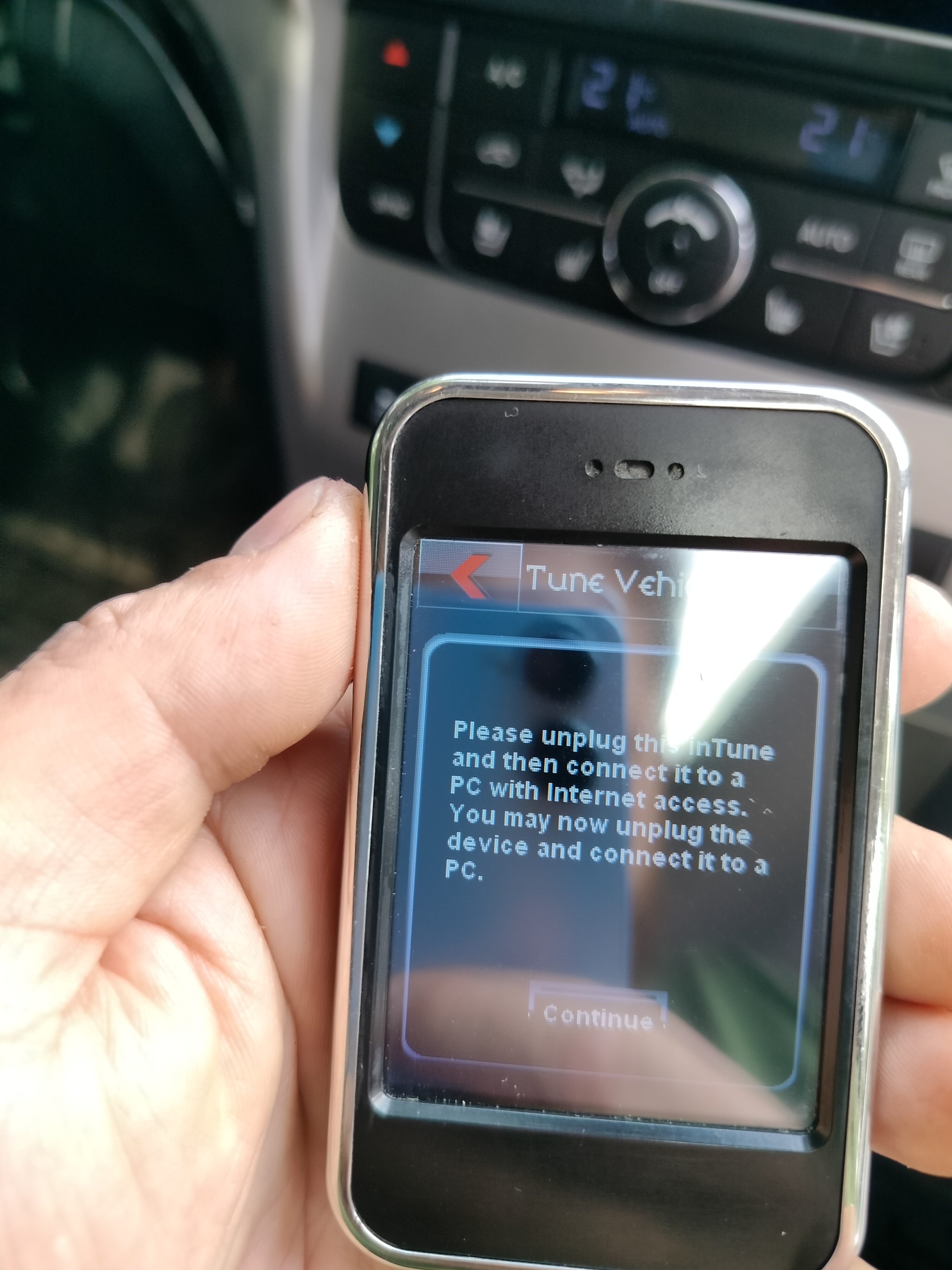

Hello, I'm asking for help. I connect the device to the car and get this message, I click the checkbox and receive the following message. I go and connect the device to the PC, it says that it is updated. I go to the car and the same thing happens, what should I do? I am attaching the info.xml file.

this device is not asking for an update?

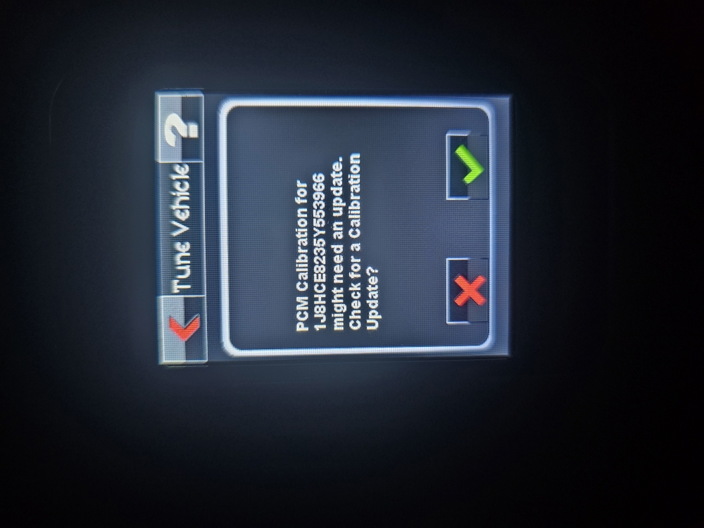

Just these messages.
I downloaded the latest updates 04i and 01u from the forum, but they don't help. Is there a solution?
- IMG20250612162040.jpg (2.21 MiB) Viewed 3346 times
- IMG20250612162021.jpg (1.95 MiB) Viewed 3346 times

the infof ile you posted is not asking for an update, which i would expect based on the images provided. Post a new copy of the info file please.

its asking for it now. Update with the update agent software and it should download the file.

you need to use the update agent software from our website and install it on your PC.
The old intune updater that lives on the device is no longer supported.
