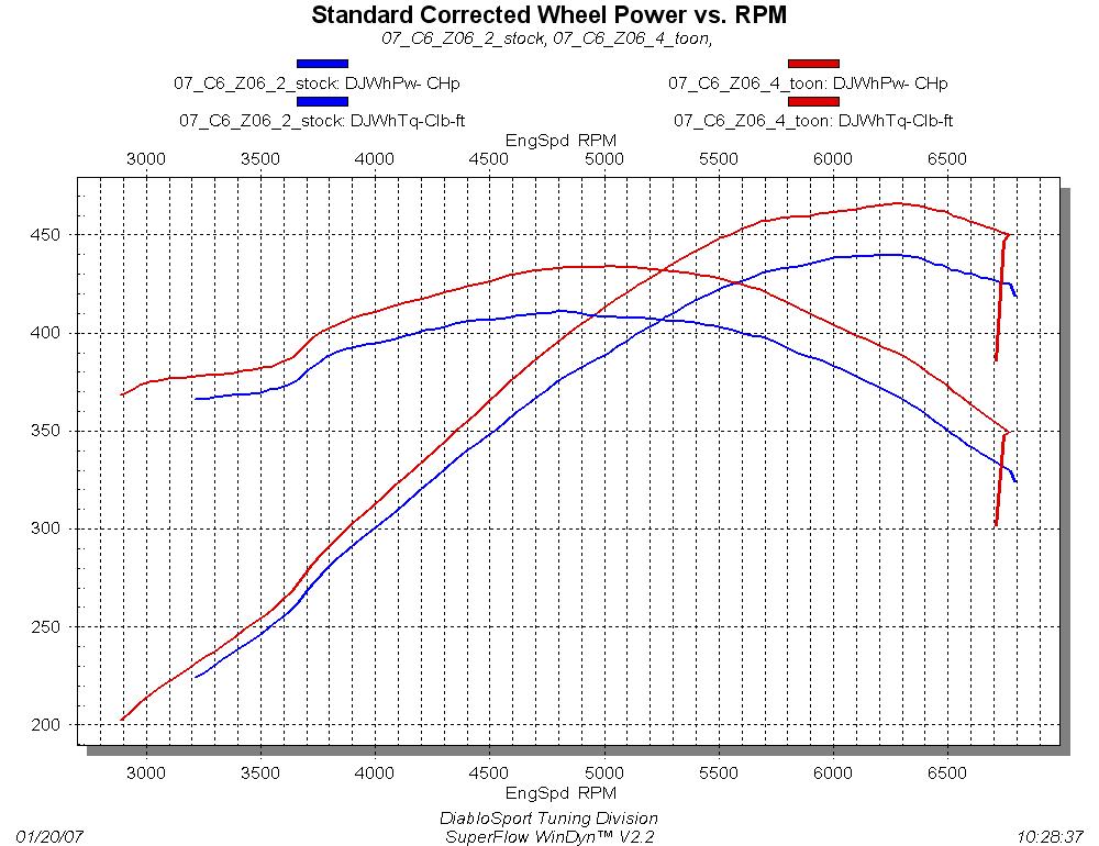

I'd call these some pretty impressive gains for an otherwise bone stock vehicle.hd-tsmith wrote:Thanks for the input. I will try this and I hope to get the results you outlined. I know fuel is critical so only the best will get it done. Thanks and I will get back to you on the results.
There is no reason that you should not be able to duplicate these gains on your car, as long as the fuel is up to the task. Remember, these cars have 11.1:1 compression ratio, so fuel quality is critical to performance.
