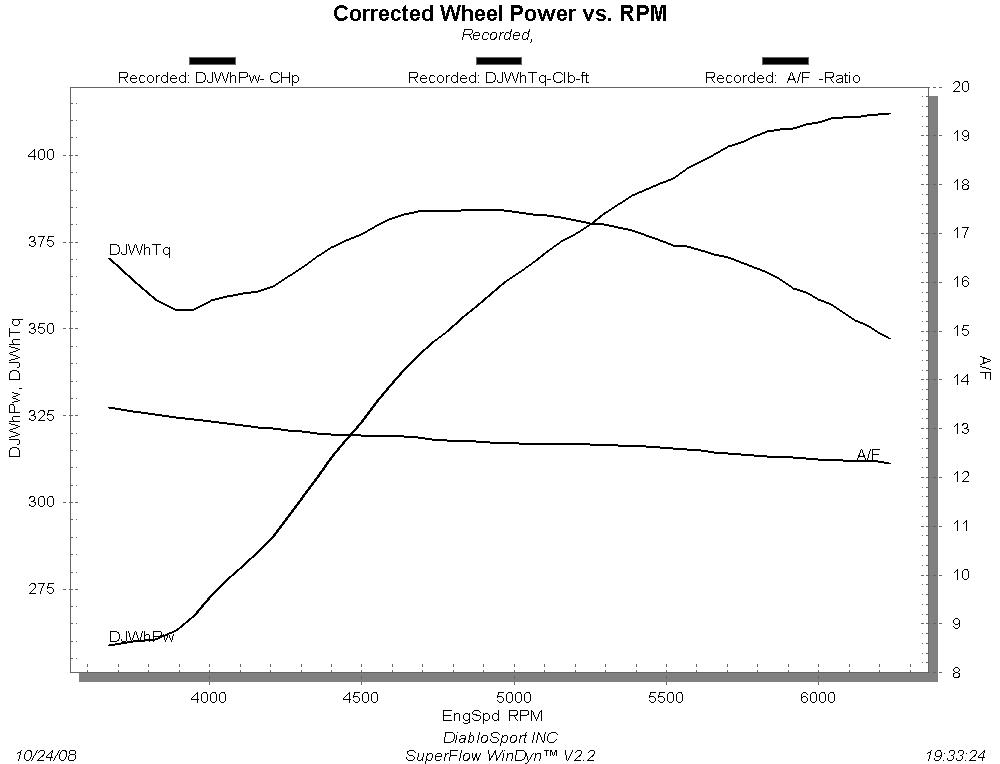

REGAINED MY RWHP
Post by bookemdano »
them stickers sure made good... :roll:

RE: REGAINED MY RWHP
huh??
no comparison in the chart man...
where's the stock lines for HP and TQ?? that looks like a stock GTO to me...
tell Johan to wake up!! where's the chart with both the before and after??!! :lol:
hey Lew, thanks for recomending Johan...
he is a nice guy,,, he made like five pulls to see
if we could lean it a bit...
the more we leaned, the more rwhp we got...
not bad for a cam swap/ springs and pushrods lol... :D

Post by johan »
Lew, we did not have enough time to pull the cam out and compare a stock pull, it was getting late. doh.....

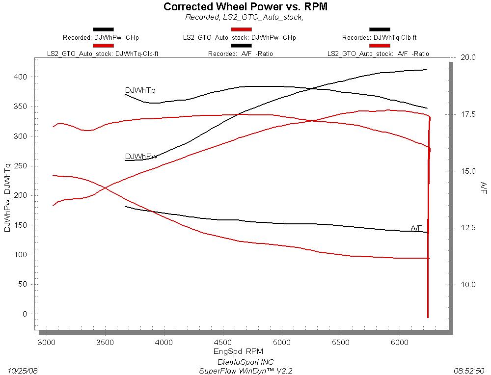

Post by johan »
Here is a comparison from a stock A4 GTO, 343 to 411 hp, 345 to 385 trq.

yeah... didn't mean to do all that... just was wondering if it was dyno'd when he first rolled in the shop for a baseline, and then after you worked your magic could compare the two... heh..
eh, no biggie, got more power, that's what counts! ;)
