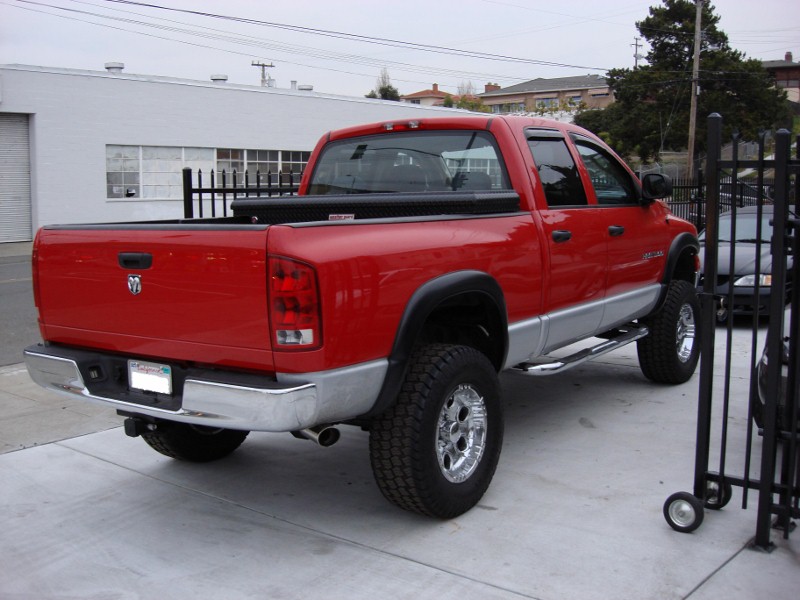

Well..... about $5500 in components for just the motor all top of the line. $4500 R&R, machine work ( crank , rods + pistons perfectly balanced , ceramic coatings, high flow cats, reworked exaust, etc.) should be able to spin this baby above 7000 rpm but I don't think it should be nessecary, more like whatever the dino shows before droping off on the hp curve.07HemiR6 wrote:Nice setup! If you don't mind me asking how much did all that cost you?atttaboy wrote:Welcome to my world of tuning lol...lol.... I know exactly how you feel. somebody sold you somthing without a real tuning solution! WELCOME My block isnt forged but all the components are. Pistons, rings, rods, crank, high strentgh bolts, heavy duty valve springs (gotta help things close under boost), hydrolic harmonic balancer, pistons and heads ceramic coated (gotta keep things cool) diamond ground valve seats (i think three different angles or something like that lol ). As for the block from what I've heard it can handle plenty hp not sure exactly how much but I'm sure somebody on here knows!
MISSING ingredient ? TUNING!!!!
Can't wait to blow my trany so I can rebuild it too......you know I'm gonna need it! lol.......lol
So Johan what say you?
- hemi (800x600).jpg (119.32 KiB) Viewed 3751 times

Engine pics or ban lol!atttaboy wrote:Well..... about $5500 in components for just the motor all top of the line. $4500 R&R, machine work ( crank , rods + pistons perfectly balanced , ceramic coatings, high flow cats, reworked exaust, etc.) should be able to spin this baby above 7000 rpm but I don't think it should be nessecary, more like whatever the dino shows before droping off on the hp curve.07HemiR6 wrote:Nice setup! If you don't mind me asking how much did all that cost you?atttaboy wrote:Welcome to my world of tuning lol...lol.... I know exactly how you feel. somebody sold you somthing without a real tuning solution! WELCOME My block isnt forged but all the components are. Pistons, rings, rods, crank, high strentgh bolts, heavy duty valve springs (gotta help things close under boost), hydrolic harmonic balancer, pistons and heads ceramic coated (gotta keep things cool) diamond ground valve seats (i think three different angles or something like that lol ). As for the block from what I've heard it can handle plenty hp not sure exactly how much but I'm sure somebody on here knows!
Insert Clever comment here...
Re: RE: Re: RE: u7137 and turbo tuning
sohfast94 wrote:Engine pics or ban lol!atttaboy wrote:Well..... about $5500 in components for just the motor all top of the line. $4500 R&R, machine work ( crank , rods + pistons perfectly balanced , ceramic coatings, high flow cats, reworked exaust, etc.) should be able to spin this baby above 7000 rpm but I don't think it should be nessecary, more like whatever the dino shows before droping off on the hp curve.07HemiR6 wrote: Nice setup! If you don't mind me asking how much did all that cost you?
As for engine pics I have some but they're at home and I work on the road. Most of the internal components came from krcfieldtech at KRC performance. I would have them tune it but they're a couple thousand miles away. Matt at nextgen auto sport in hayward california built it call him brian he'll tell you exactly whats in it. He is one of your dealers and all, but he's having a hard time stomaching the money required to purchase the DCX package from you guy's otherwise he would be tuning it. I've been screwing with this for two years and have yet to fully enjoy my investment.
- hemi 2 (800x600).jpg (114.98 KiB) Viewed 3740 times
