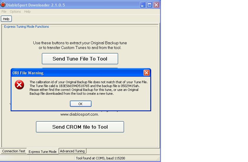

Sorry, I'm unable to load this file into the predator. I have attached a screenshot.
sohfast94
Posts: 3512
Post by sohfast94 »
Try not using the last saved and browse for the backup.

there was something wrong with the tune that Rage made... It was made off of the wrong backup I believe so I made it off his backup and checked everything over and wa-la. All fixed..
