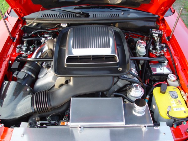

In the meantime, here's a pic of the motor, all dressed up!
Thanks!
Chris
