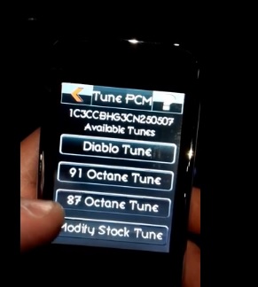

I only seem to have the 91 octane, 87 octane, Diablo tune, and modify stock tune. No 93 tune, WTH!

Re: 08-13 Avengers....
Mmmm...now that you mention it, it's possible I wasn't paying attention close enough and I only have diablo tune on top as well. I'll check in the morning. I was/am very tired from long day at work and knew I could only play with 87 tonight anyway since I have crappy gas in the tank.
93 tune is the diablo tune....
