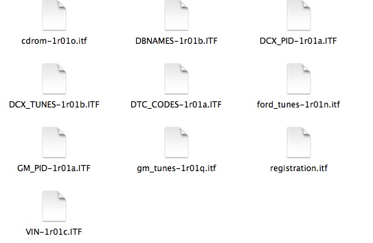

Re: Latest Intune release here.
Hmmm..I just added the following:
No it wouldn'tmikel wrote:A PC would make life much simpler
- Mac running Windows!
- Screen Shot 2013-06-20.png (621.73 KiB) Viewed 7547 times
UPDATE:
Using my Mac, I got the device looking right; I checked using a PC and it said it was up to date.
I installed the device into my car, picked a setting, and it began to start tuning. At the end of the tune, I got this message "PCM has been tuned by a Diablosport product", which of course was by me with the same device. It then instructed me to plug it into a PC. The device began to fire up, but without icons. When I 'opened' the device with the PC, no files were present. Nothing.
Please help
Please help
