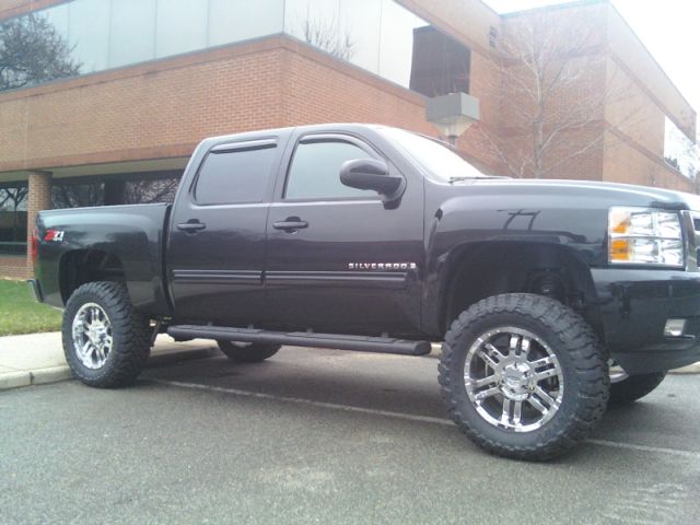

Just wanted to give everybody an update on this. Last week I had my lift and 35's installed. Using the Preditor I adjusted for tire size and previously I had taken the speed limiter off. No issues at all. No lights, nothing, worked fine. Speedo is only a few mph off (to the low side) at 70 mph. Also, stock gearing seems to be fine. With the larger tires the truck no longer wants to race into 6th gear around town, stays in 5th now where it needs to be under 45 mph or so. On the highway it enguages in 6th around 60-65 mph and seems to use 5th gear more effeciently now then as before when the truck would labor in 6th going up slight grades. The 4x4 shop owner said he wouldn't change a thing with the gearing. Not a very good picture, it's been raining here all week and I haven't had a chance to wash it and take some better pictures...this was from my cell phone. thanks again for everybody's input and help.

let me try the picture again...
Posts: 18087
nice lookin' truck man!!
