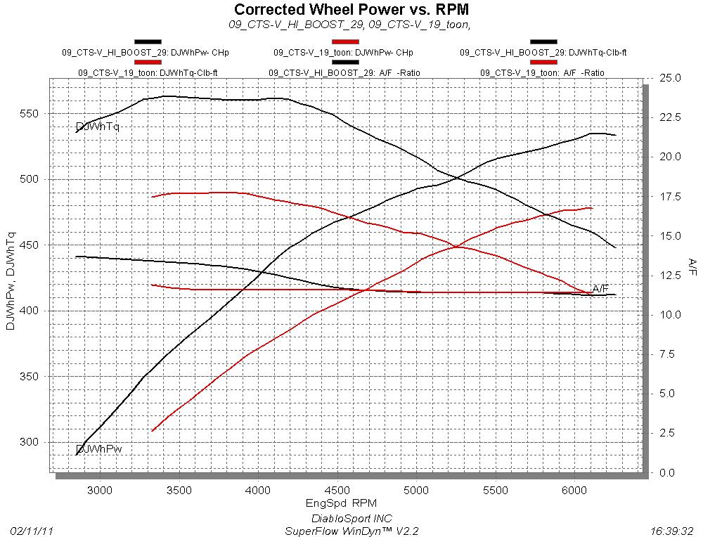

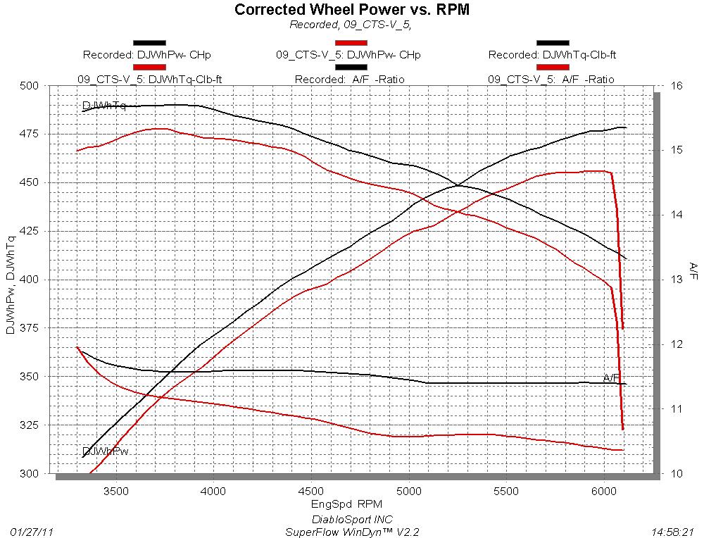

We've tuned a bunch, here, and Johans done a few on the side on a MD, but they all make great power.
lemme see if I can dig up Marsads dyno sheet...

second one is stock vs tune only, first is stock tuned vs pulley+tune
Note how fat the stock tune is....

this car went like 11.59 at 123 on stock tires, just pulley, CAI, heat exchanger, and a conservative tune.
