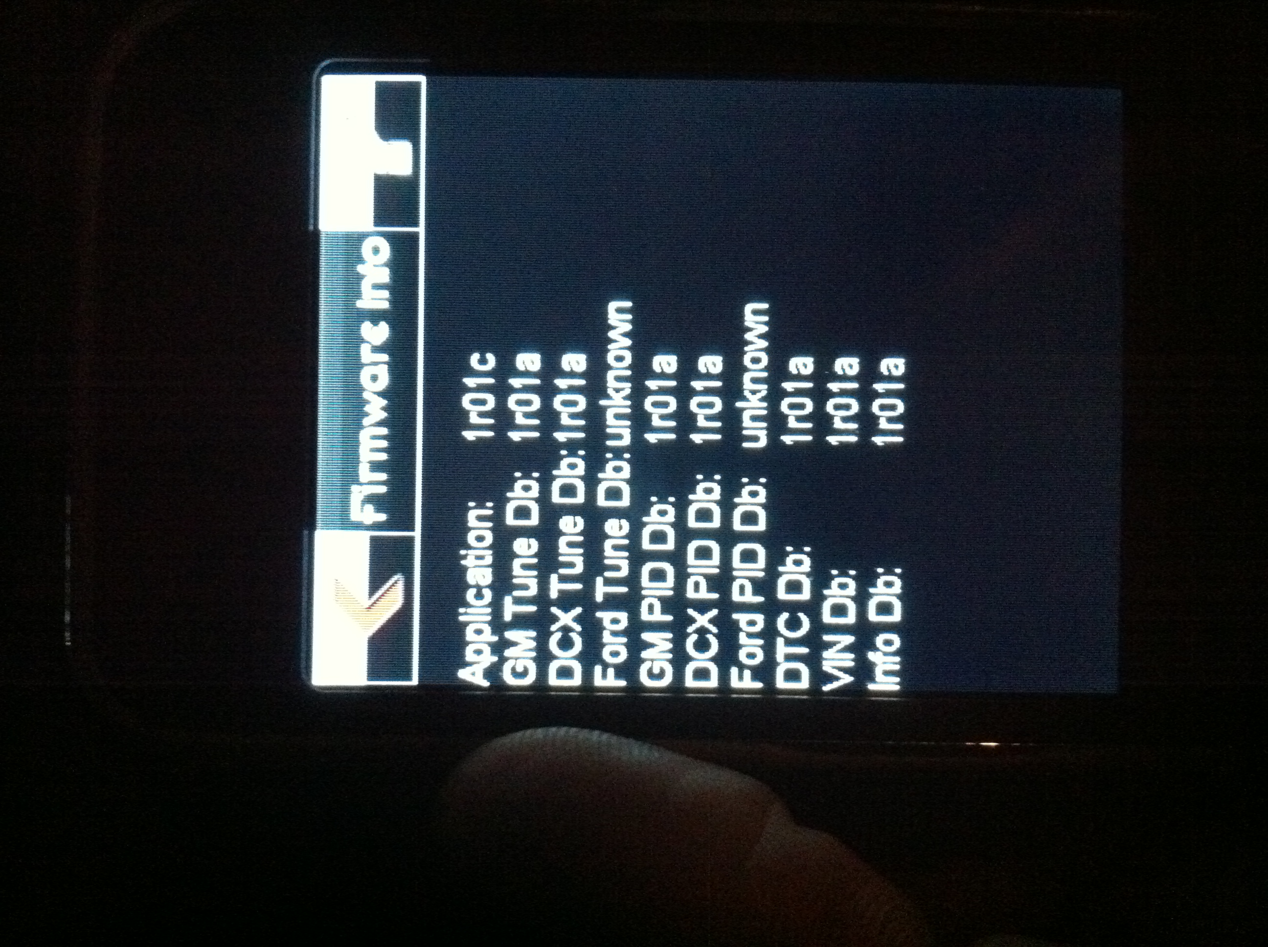

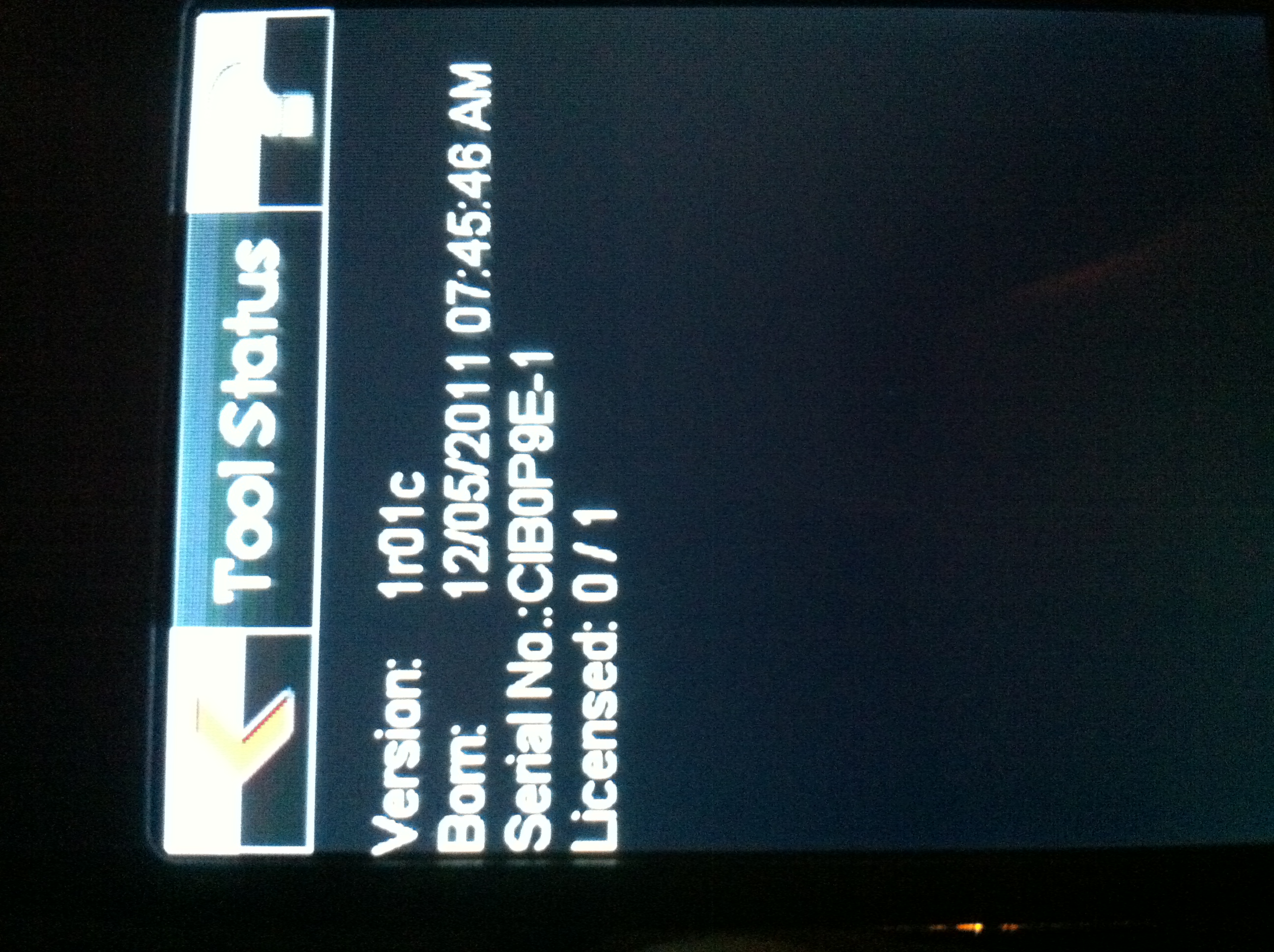

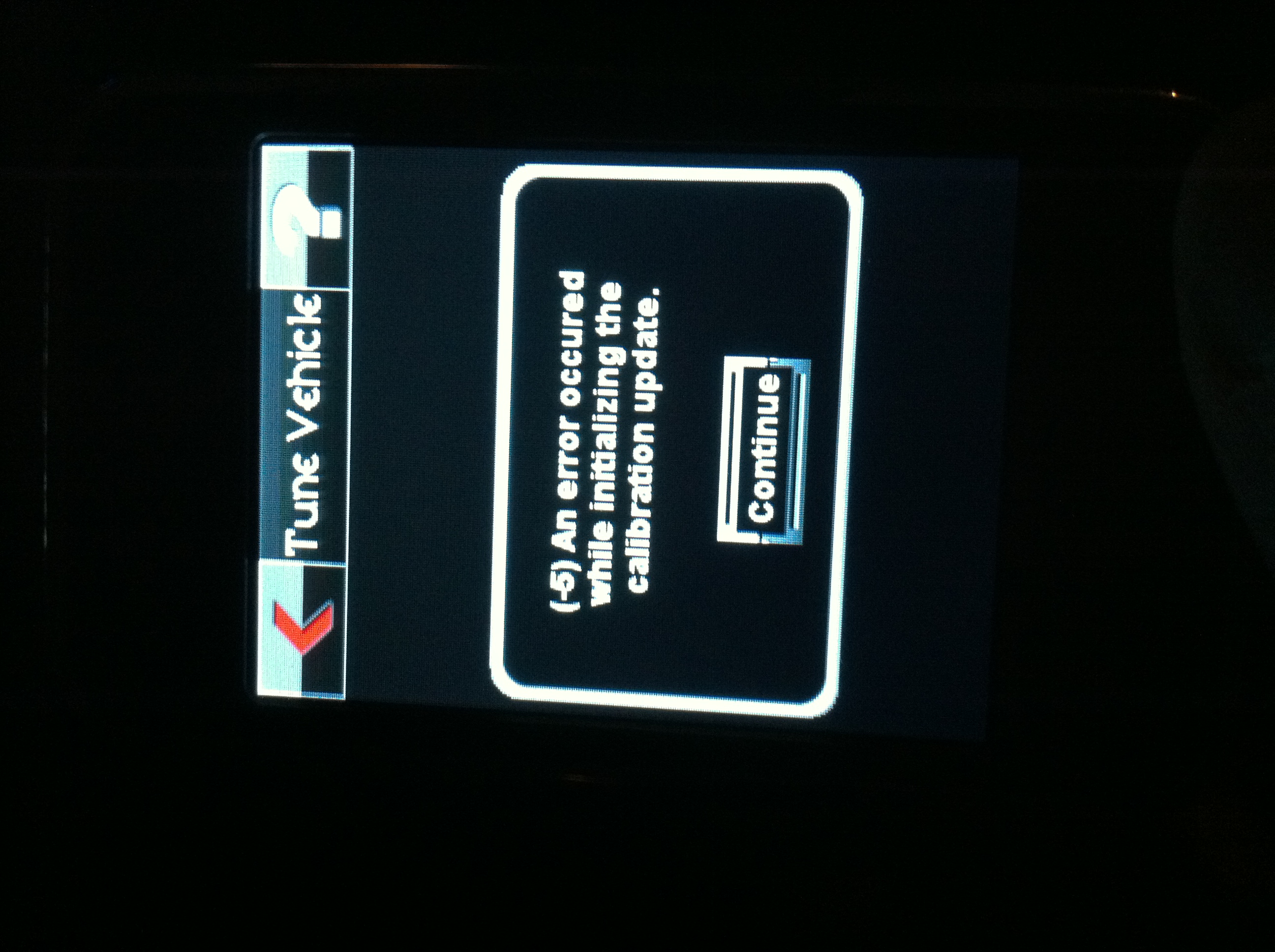

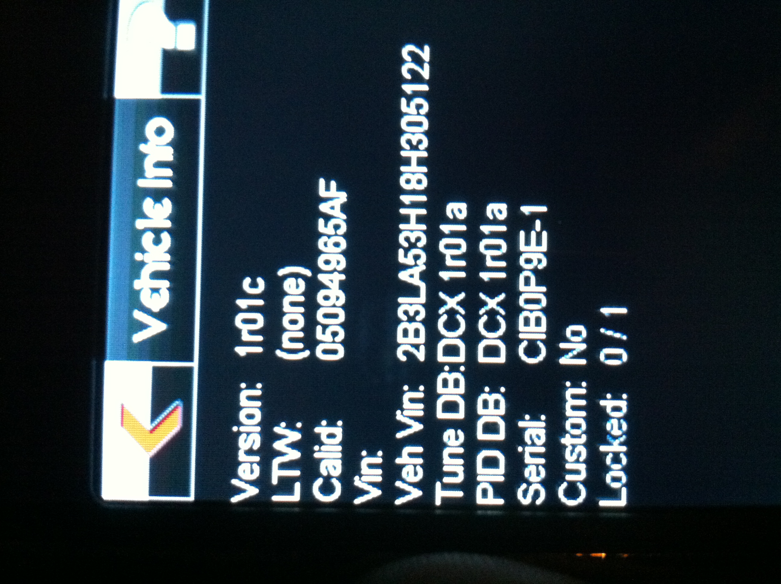

Just got my inTune yesterday and I'm one of the lucky ones with the -5 error too. 2008 Dodge Charger RT. The calid is 05094965AF. I took pics of all the info screens if you need any more info.

would you mind posting those pics in here?
No, i don't work here.
error pics
Not sure why the pics ended up sideways but here you go...

I got mine working by deleting the drg file and re updating it
