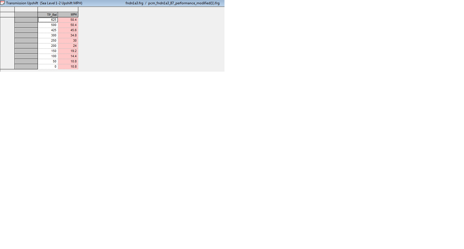

I loaded the latest and then set the shift up in mph and there is no difference. I did not try to raise the shift by RPM though. Is it tied to that setting? When you tune for mph, there is absolutely no difference over stock.

Post your last tune written please.

Here is the last tune.

As you can see it is in fact working although the "20" is only 20% equating to about 8.1mph....

OK, I think we are on to something, but with all of them at max, its not enough of a difference. Is there a way to increase the parameters. I would love for the minimum speed for the 5 to 6 shift to be 55mph, and I am getting in there early. I know an issue is backpedaling. As soon as I let off, I guess its going to shift.
