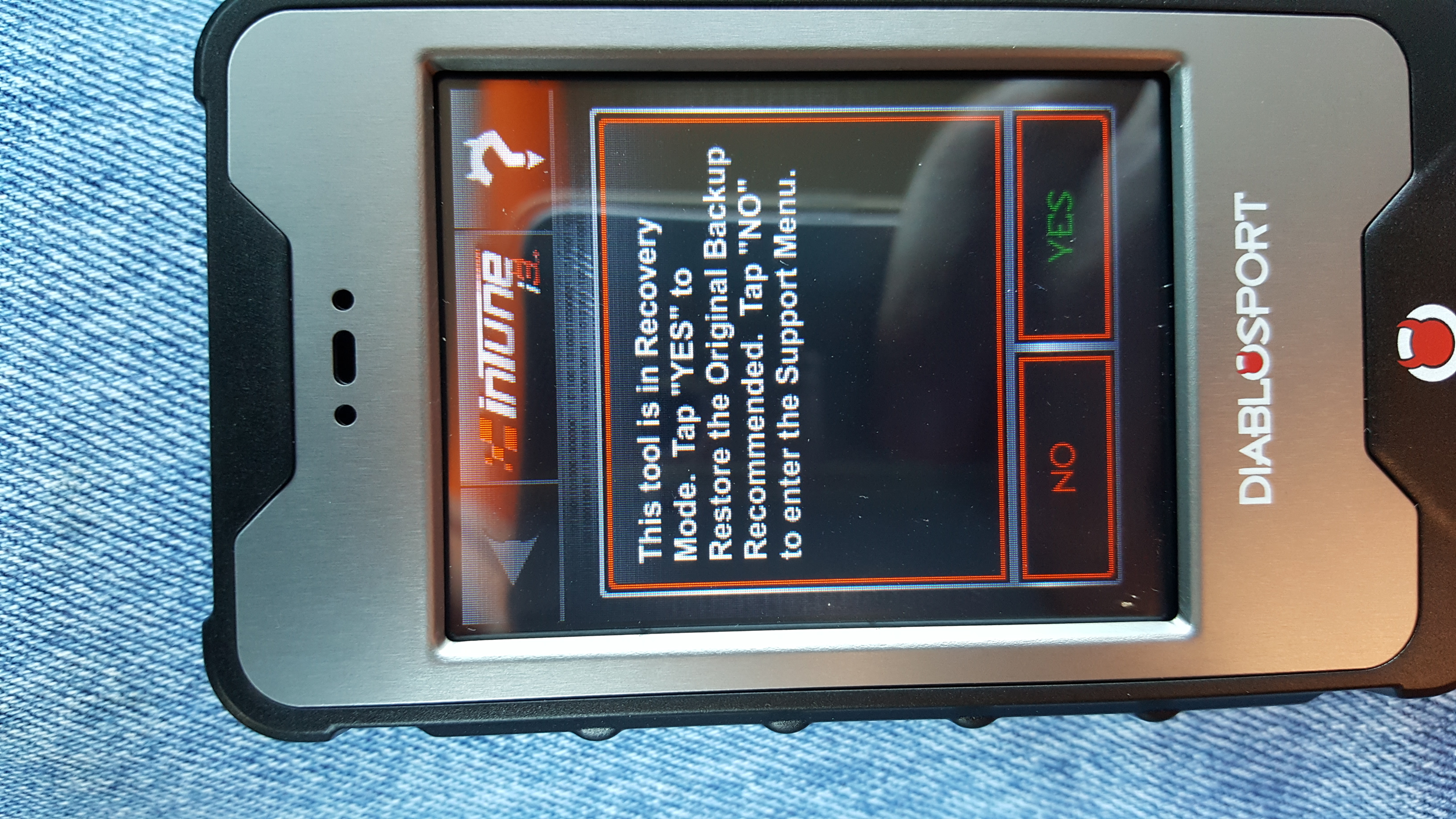

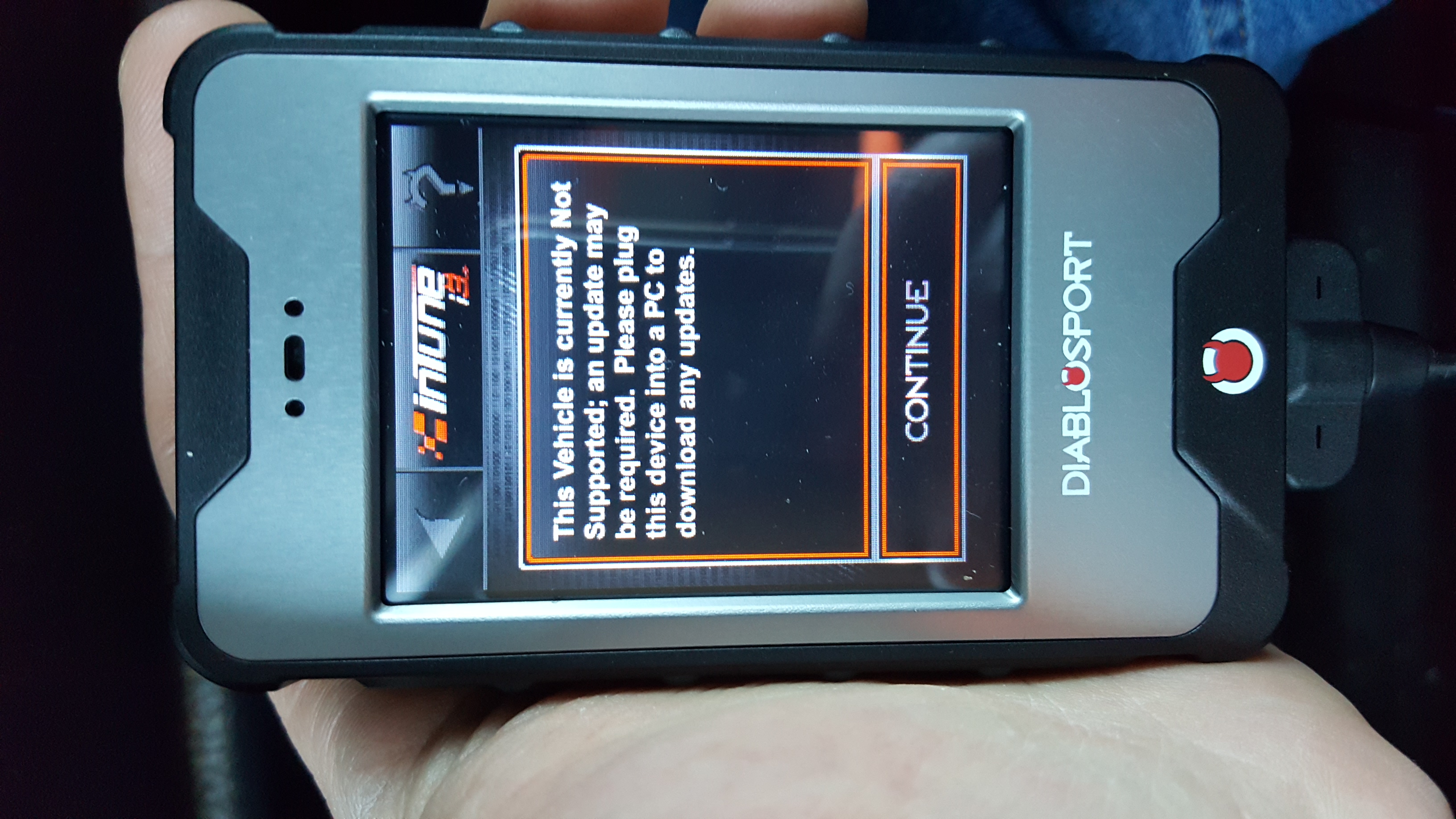

I managed to read a copy and Jeff from Banks sent me the side winder tune. However, when I try to load any of the tunes I keep getting this
TJTurbo
Posts: 28
Joined: Fri Dec 11, 2015 1:42 pm
Re: 42RLE Transmission 2006 Jeep Wrangler
Post by TJTurbo »
Okay, I know what I did wrong...I put Jeff's tune in the "tunes" folder. Then I restored the back up etc. until i got to this point. Hope I haven't fubared this thing up too bad. I haven't and won't crank it until I hear back from you guys on Mon. Thanks
