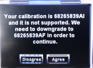

Hi,
My truck (2016 RAM1500 5.7l) just went for some recalls (U61 Cruise Control, U07 Auto Park and U53 Occupant restraint controls module)at the dealership.
Prior to the recalls at the dealerships I loaded the original backup prior into the Diablo unlocked PCM.
The Diablo Trinity says that my custom tune (68......AF) is no longer supported and that calibration ID (68...AI) is not supported.
Furthermore it ask to downgrade to "68...AF".
What should I do now? Should I really downgrade??
I want to keep the recalls of RAM in my truck but I want to use the Diablo tunes and the custom tunes as well...
Help.......

Re: Recalls and diablo PCMs
its putting you back on the same cal you were on previously, which is the one we support, let it do its thing.
You'll also be able to reuse the custom tune once the cal is backdated.
