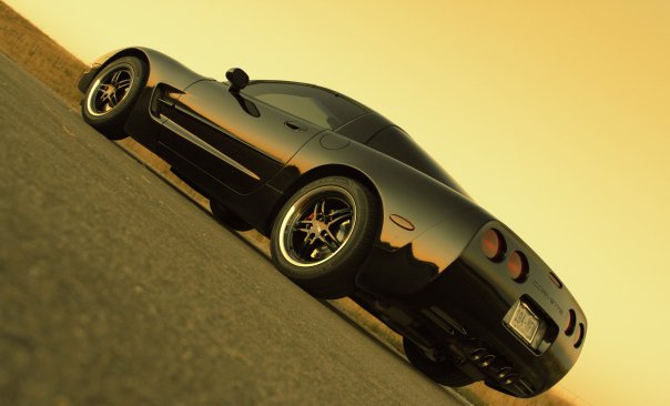

My car is a 99 LS1 C5 corvette with heads, cam, rockers, injectors, nitrous, headers, A4 auto transmission. My wideband gauge reads about 9.5 on part throttle. I have changed the injector slope to adjust for my larger injectors a pretty significant amount, but my a/f ratio doesnt seem to change any. The car is running pretty rich. Anyone have any ideas/ suggestions?
BTW - my LTFT are about -15, i've added about 30 to the injector slope but no change
