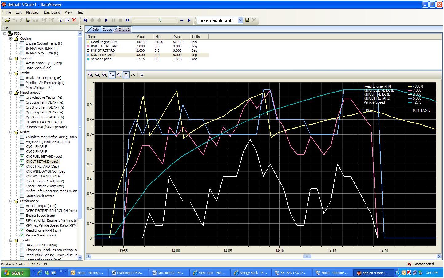

I played with the Tuner as far as WOT but I went back to the default tune because of KNK in ST and LT… It’s a lot better now; I only get KNK when I’m really getting on it... I have attached the log from this morning but I installed the default 93CAI and need to give it a few day to adapt.. I need someone smarter than me to have a look at the log file and tell me what they think.. Thanks in advance…
The Screen shot is from a 5mph roll w/ auto shift

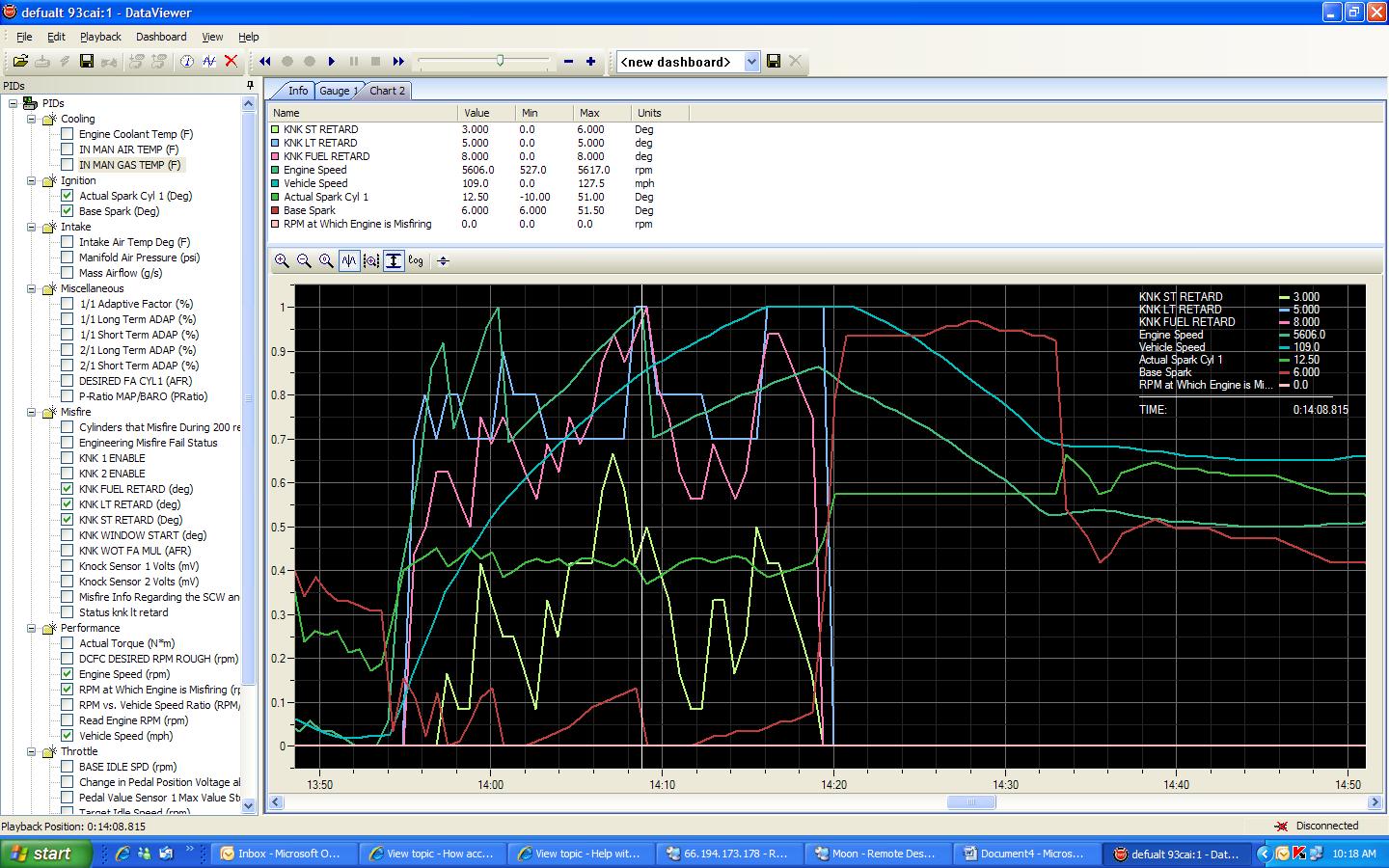

Here is the complete log file from this morning.. Thanks

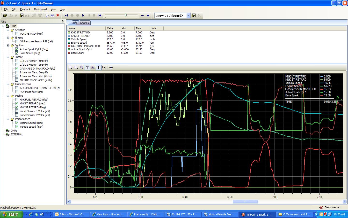

Hey Thanks I logged that in that PID in that run.
I set the marker right at the top of 3rd gear

and her is +5 fuel -1 Spark w/ 0 to 60 time.in the next post
Post by ywait »
and her is +5 fuel -1 Spark w/ 0 to 60 time.in the next post.

+ 5 Fuel and -1 Spark
Post by ywait »
This +5 Fuel and -1 Spark in from the run I did Last Night.
