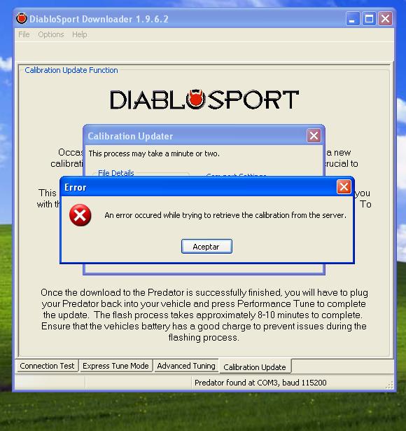

i sent an email yesterday, it never let me update, first it was the message asking if i was connected to the internet, now im getting a new another message it tells me "an error occurred while trying to retrieve the calibration from the server"
mike if you ever see this why it doesnt let us update the calibration on the predator? as stated on step 5???
My calID is 05187099AD

Re: RE: Re: RE: Re: RE: Re: RE: Re: RE: MEXICO AND DIABLOSPO
Smoke74, you should be good to go. Follow these instructions:smoke74 wrote:i sent an email yesterday, it never let me update, first it was the message asking if i was connected to the internet, now im getting a new another message it tells me "an error occurred while trying to retrieve the calibration from the server"
Install the 8t16c CROM from u7135-8t16c.
Then go plug into your vehicle and try Performance Tune.
After that, you should not need an update, as your Calibration is already current.
On the side, Christy never received an email from you. No problem, you should be fixed after following the instructions above.

RE: Re: RE: Re: RE: Re: RE: Re: RE: Re: RE: MEXICO AND DIABL
Hi John... I tried the above, it is not working for me... any idea why? my cal is 05187100AB
please help!
