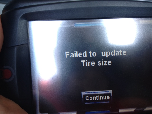

Re: Trinity upgrade
Mikel,
The Tool Worked! I was able to apply the 91 tune to the truck and it is working very nice. I was also able to modify the parameter for the speed limit, but unfortunatly I was unable to modify the tire size.
I get the following error....
Can you please help?

Re: Trinity upgrade
this is my tol info...
