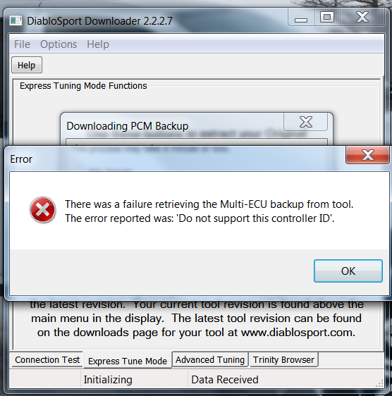

To add to speedys inquiry, Im also curious on this. But i added an attachment of the error i receive when i try to recover the TCM factory back up.
- error.png (123.26 KiB) Viewed 6000 times
