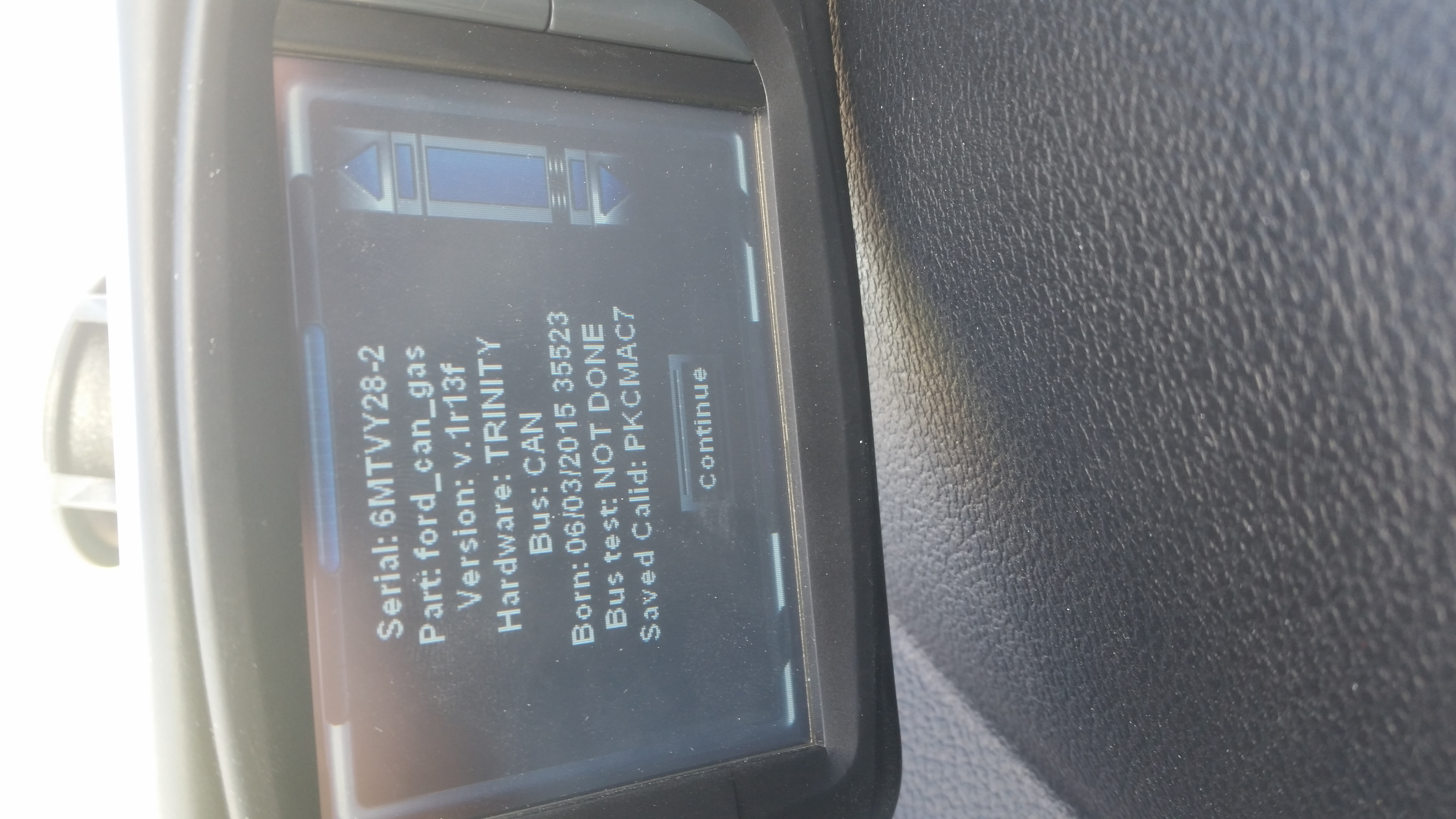

I tune the truck, and after everythings all said and done and it says you may drive your vehicle. I start it and the throttle doesnt work. Brian was helping me with this for a couple weeks, and there was a couple times where the truck would seem like its working fine after the tune is installed, but shortly after that when i started it again the throttle wouldnt work. I have never gotten the drag tree to work or the 0-60 timer, so i figure its just something that i am doing wrong, so i wanted to start over completely
Posts: 58694
Re: 2015 F150
OK, to confirm, please go to options/show information and tell us the current version it shows.

And I've Brian asked me to do this already a week or 2 ago, and he verified it looked alright. But it all just continues to happen. So I would just like to delete the drivers and everything and start over to see if I get the same results, If that is possible.
So would I have to delete the drivers off my computer and then erase all the date on the trinity?
Posts: 58694
Re: 2015 F150
drivers, nor anything on your pc are related issues here.
I want to confirm that you have loaded the last update brian posted, please provide that version info when you can.

Even though it's the same issue with 4 different tunes? At this point, if it's not how it was loaded on my PC, and it's not the tunes, then as far as I can tell. It's my trinity or my truck. But I'll post a picture of the version when I can.
Posts: 58694
Re: 2015 F150
If the update isn't loaded then we haven't gotten anywhere, so the first step is confirming that was loaded to the tool properly.

Here's the info screen. When the tunes did work for me, I also experienced the lurching he was describing, but it was when I had cruise control set and was going up a hill.
Roiceed
Posts: 62
Joined: Fri May 01, 2015 9:16 pm
Re: 2015 F150
Post by Roiceed »
Wow that picture turned out terrible. Whoops :punisher:
Posts: 58694
Re: 2015 F150
it worked, i see its got the f release on it.
