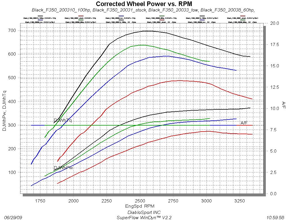

here ya go, i probably should have put this on both threads..
It's at the wheels knelson, its 377/700 at the wheels, so add 20% to that and youll get your flywheel output
Black = 100hp
Green =60hp
Blue = tow
Red = stock
the tow put out more then i expected, but i decided not to lower it, the 60 hp gains about 10hp peak and a ton more hp down lower and about 45 ft lbs more then the tow....then you can see the 100..that one is self explanatory :D

Beautiful. I'm going to print that and put it on my garage wall. Thanks Guys.
