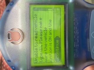

I am trying to get this thing running again after it was sitting for a while. I am having the same symptoms I was having before your custom tune worked, no crank no fire. I figured I would just reload the file, but When I hook up my Predator, I cant seem to get it to talk to the PCM. Here is the error I’m getting.
I have double checked all my wiring, I also thought maybe the PCM went bad, so I bought a replacement, but I still have the same issues. Is there anything that I’m missing, should the Predator still work just fine? Do i need to update it?

if the tune was previously loaded and the truck was running on that tune, and the pcm hadn't changed, then it should still run.
if not, something else has likely changed. The pcm should not die just sitting
