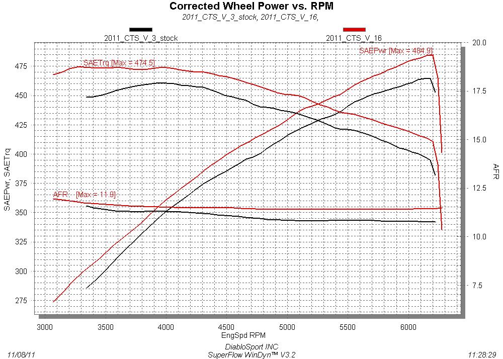

I saw 484 rwhp after the tune today, with consistent back to back pulls.

Really? Thats a BIG gain. These cars are losing generally 18% through the drivetrain, so 484 at the wheels would be 590 at the flywheel. A 34hp gain. NICE!

Dyno graph? Got it. Really liking the big torque gain before the peak.

I suppose I can share the dyno
- 2011_CTSV_stock_toon.jpg (199.31 KiB) Viewed 3971 times
