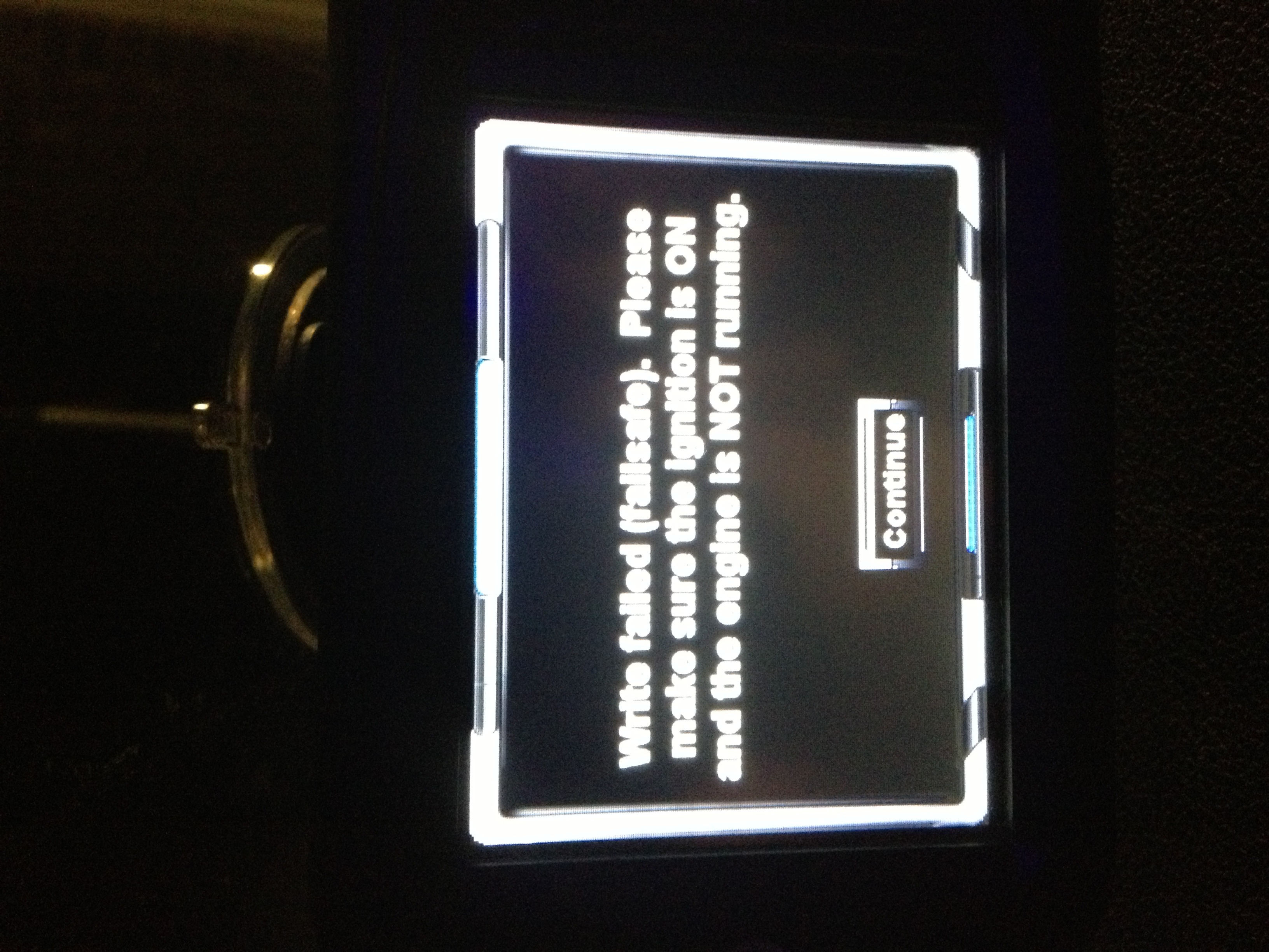

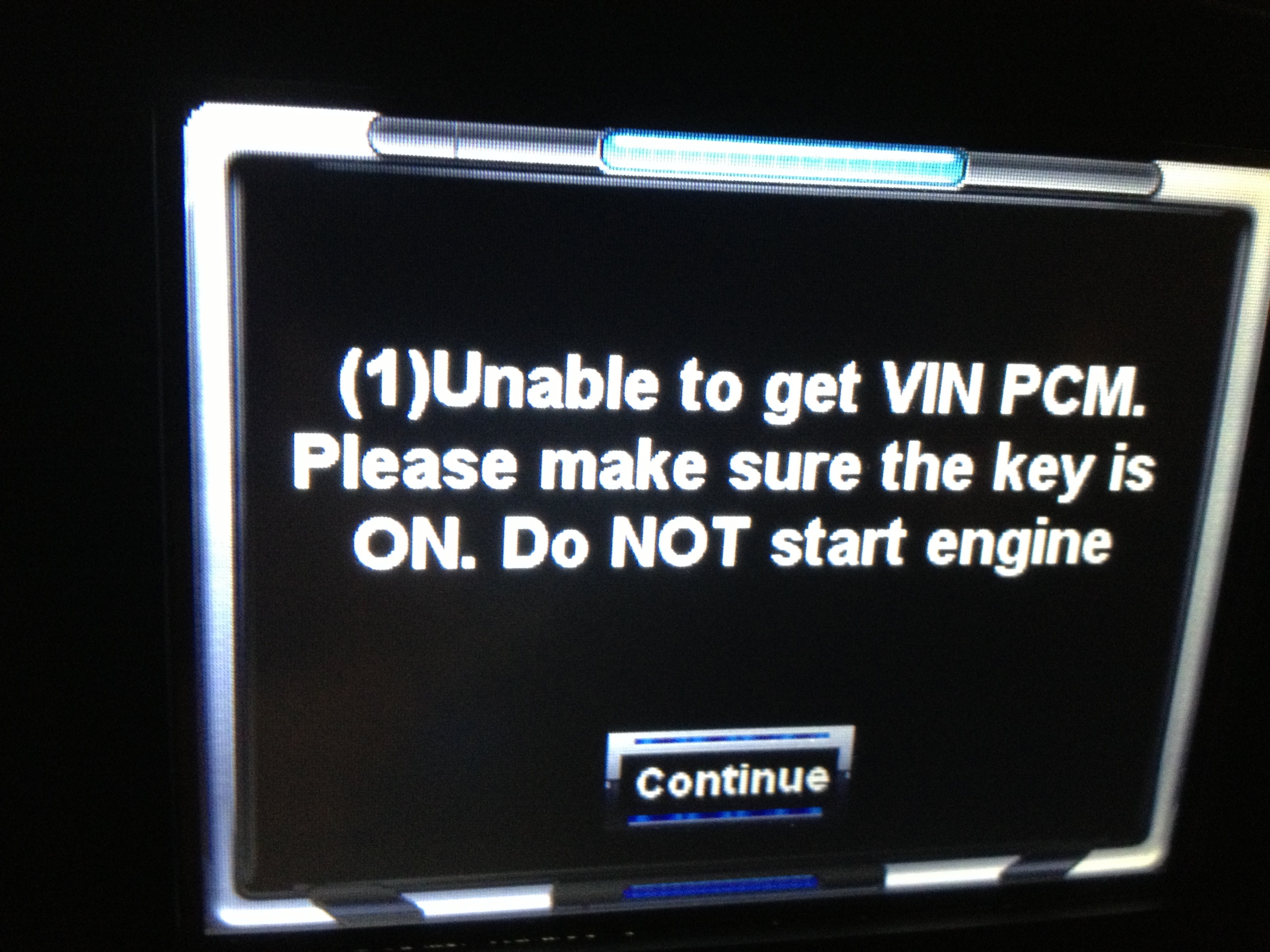

My car bricked again!!! This time the symptoms are worse, before it would start but would shut off, now it's just dead, no ignition at all, there's a red dot light blinking that never was there, and whole different things on the trinity then last time. I tried to load tune earlier and it told me it could not because there was already a tune and it could not restore backup because no backup existed, so I figured I'd call diablo in the morning since my car was operating on the stock tune. I just went to car and decided to try it again, this time it stArted to go through the process but then I seen something on the dash that I had never seen when loading a tune and I swear my heart sunk
It said a lot of scary thing before but never this
Then I got this message
And then this one
And then this one
And then this one
And then this one
And finally this one...
You can im agine I unplugged and repeated these steps ten times already, my car has different symptoms then before, now there is a little red light above the steering wheel blinking, and that park assist thing has never showed up when putting in prior tunes (that actually worked). I even went to options/troubleshooting/show vin and it can't seem to see my vin, it keeps telling me to make sure the key is in the on position or unplug and retry. Man I am so dressing this phone call tomarrow, by the way, I have the b code and it still bricked!!!

That sucks. My Intune is "bricked" so I feel your pain. Also, those warning lights shouldn't be anything concerned about, it always does that when saving/loading a tune. First time I saw that with a Predator, I had the similar heart sinking feeling.

SRTGR8T wrote:My car bricked again!!! This time the symptoms are worse, before it would start but would shut off, now it's just dead, no ignition at all, there's a red dot light blinking that never was there, and whole different things on the trinity then last time. I tried to load tune earlier and it told me it could not because there was already a tune and it could not restore backup because no backup existed, so I figured I'd call diablo in the morning since my car was operating on the stock tune. I just went to car and decided to try it again, this time it stArted to go through the process but then I seen something on the dash that I had never seen when loading a tune and I swear my heart sunk
And then this one
And then this one
And then this one
And then this one
same shit just happened to me. how was this fixed?????? i have this new d code. @##$%!!! :evil:

diablosport...when you get back from holidays please help me.
i have bricked my car the second time. see above post. different from my first bricking where i had ignition. NOW I HAVE NO IGNITION and the tool cant even connect to the pcm like it could the first time it bricked. the above description is what happened to my car. same as srt8gr8t where there is a flashing red light above the steering wheel and it tells me to press clutch in to start car???? and no ignition when i try to start the car. the fuel pump priming sound is also gone. i updated the trinity to the 'd' file on the website. i have flashed the car a few times with the 'b' file and had NO issues whatsoever. what has changed in the file to cause this? are you closer to knowing now after the 'c' file debacle?
please email me asap. i am calling internationally and the 1 hour hold waiting is killing me. i dont mean to ask for preferential treatment but i am not calling from locally and it is close to midnight here whenever you guys are open. is there some way i can get you guys directly just this once????
