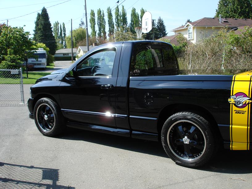

SCT CUSTOMED tuned here (hemifever does my custom tuning my guy cant figure it out either) with a comps 268 cam with the works done. stall gears injectors, p/p heads, exhaust headers etc... I have the surge as well. Would purchase a daiblo if the surge thing was figured out....will be watching this thread! Just wanted to say I guess i'm one of the 1%!
- DSC00343.JPG (122.46 KiB) Viewed 3640 times
