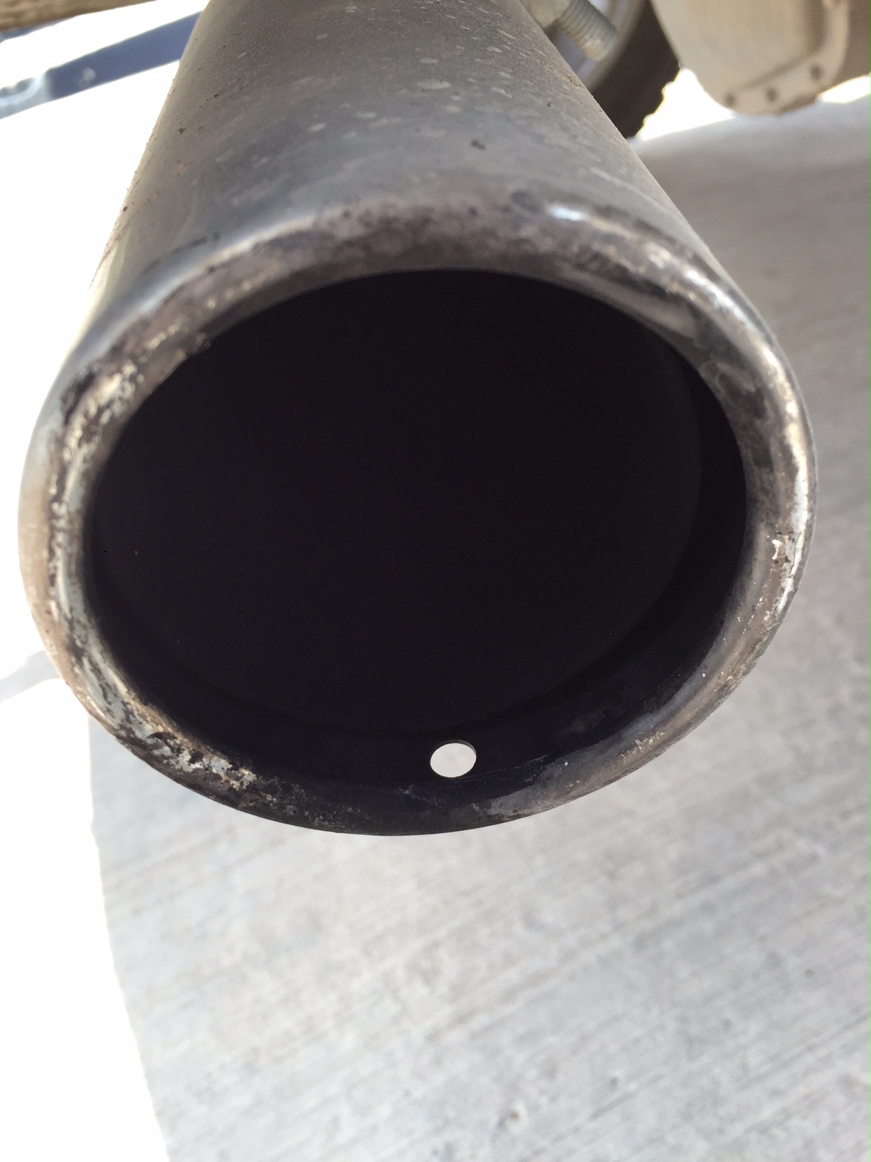

I removed the tune from the truck since it didn´t behave correctly it increased the fuel consumption in a 40% also on the exhaust i found
Heavy carbon deposits , during the test check engine lamp pop up at intermitent cycles , today i´m going to try the 91 performance tune
FullSizeRender (2).jpg (389.73 KiB) Viewed 6926 times
sohfast94
Posts: 3512
Re: 2015 F150
Post by sohfast94 »
I would check plug gap
