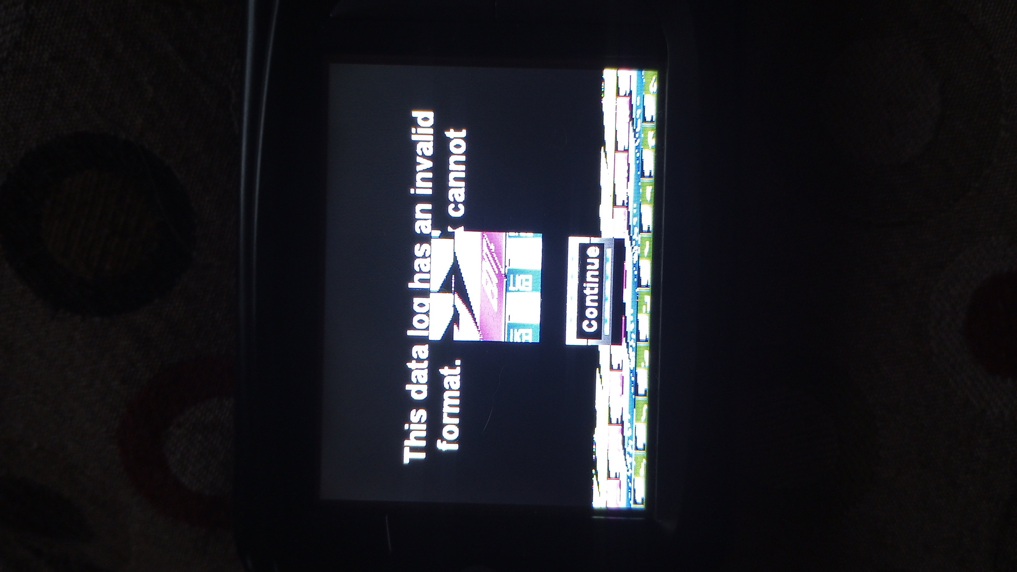

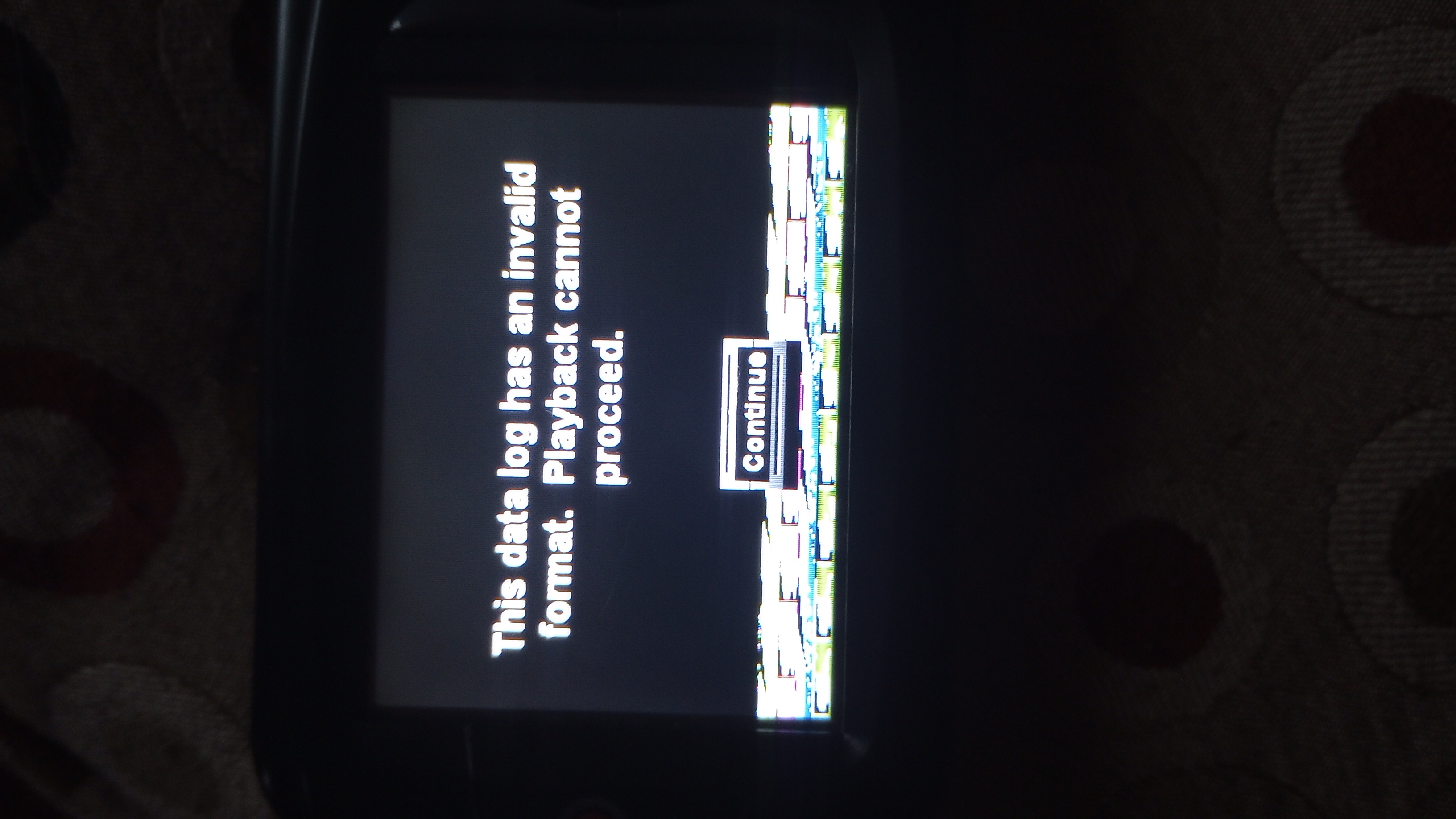

I have screen shots I took of the tool reporting some of the logs I tried to open as being corrupt.
Also, I *just* now tried to delete again after going through the process 107 times, and now it's letting me delete logs without the tool crashing. I'll report back in a bit.

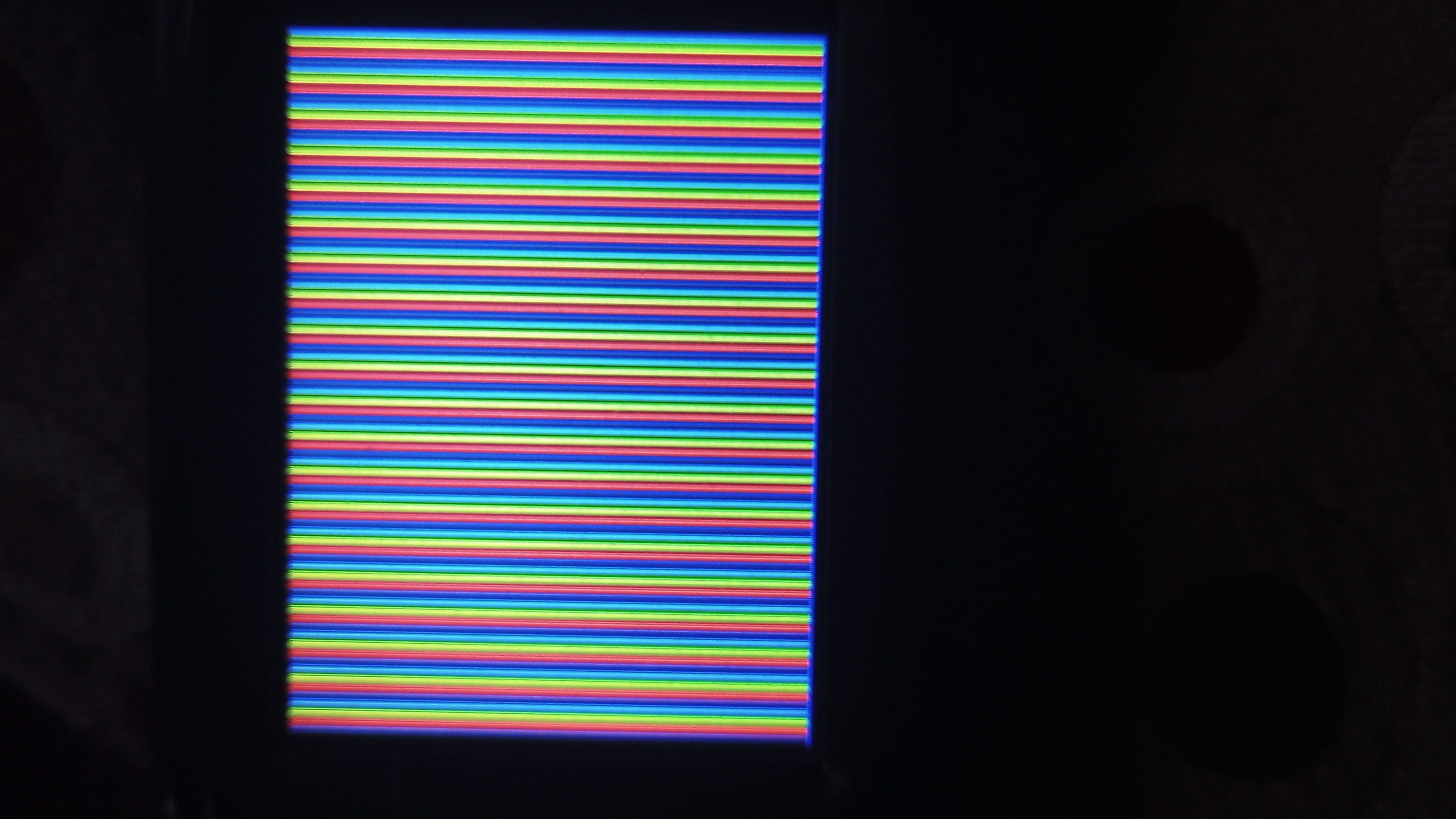

now to see if DSD and DV will talk to it correctly.

so, progress, then another roadblock?
kinda looks like this device might be on its last leg.
