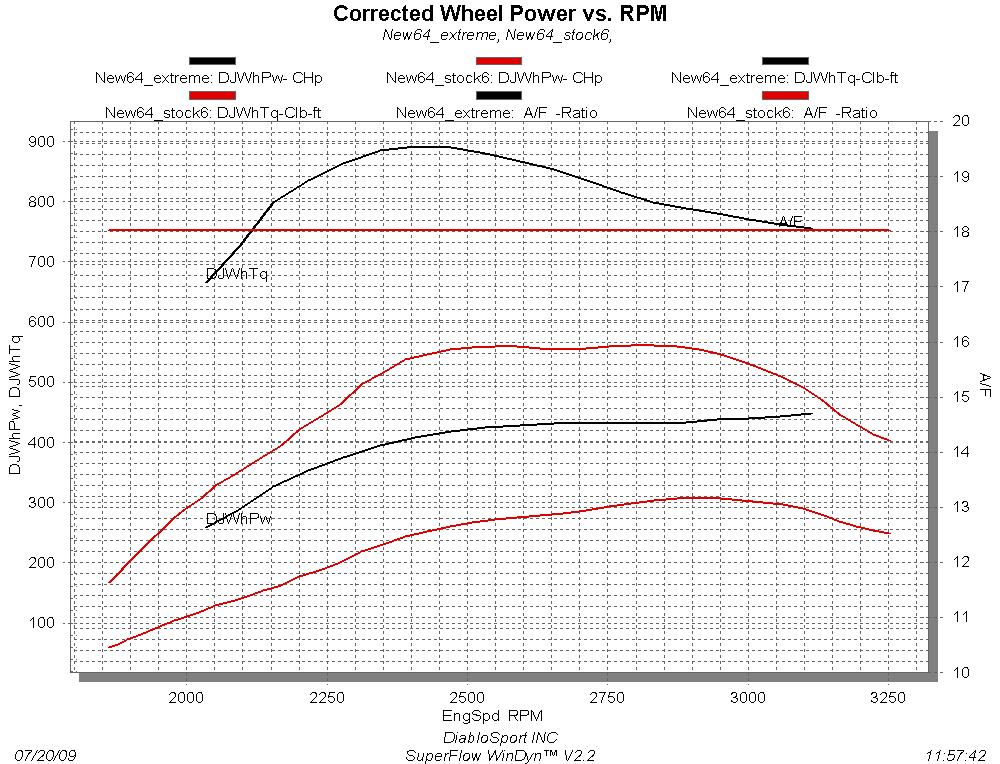

Here's a dyno graph for everyone.. extreme v.s. stock
