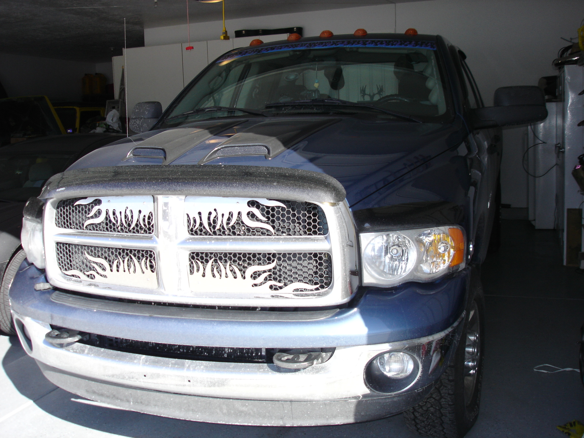

U7130, 9r03 crom file,2005 dodge ram 3500, 5 inch exhaust, Pillar gauges, Pyro, EGT's and Boost, K&N quik kit, Predator performance modular. 2 scoops, Ghost flames on front, Grill insert, Air ride system.
Works it's but off, Just got back. Not pulling anything just brke off 2 bolts on exhaust manifold
