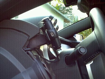

even after the 1t08ae Update in June´11 i still had problems.
Once the Engine stopped at 60mph .
then i ordered a new cable in august´11 ,did a solid mount to avoid loose cable, and no Problems anymore. more than 6 Month now
1. is there a posibility to show the actual / live / instant MPG on the Trinity ???
2. is it posible to change dragstrip 0-60 mph to 0-100 km/h ?
Thanks!
Just for your Info:VauMann wrote: June-2011
Could it be the Cable??
- Mount1.jpeg (25.84 KiB) Viewed 6377 times
- cable fixed
- Mount2.jpeg (26.09 KiB) Viewed 6377 times
- easy to take out
- Mount3.jpeg (23.95 KiB) Viewed 6377 times
