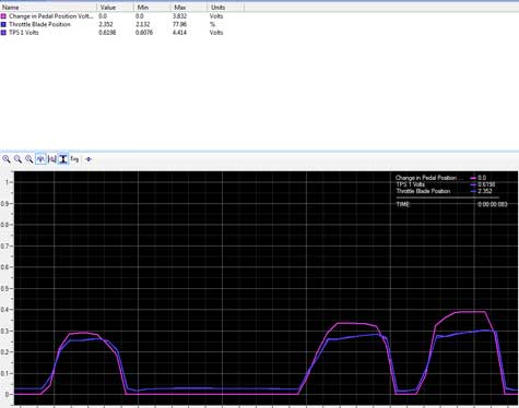

Here are some screen shots from the data log:
In this screen shot, you can see the pink line is my pedal position and the purple lines are the throttle blade and TPS volts. Notice that the follow each other like they should. There is no issue here. This is cruising along in 4th and easing on and off the throttle 3 separate times.

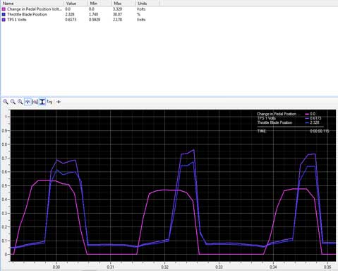

Now, after the adaptives do whatever they do, this occurs immediately after going WOT and resuming normal driving. Notice how the pink line (me stepping on the throttle) comes quite a bit before the TPS volts and throttle blade respond. This feels like the throttle is dead then the car bucks forward like it tries to catch up. This is cruising along in 4th about 40mph and just easing on and off the throttle three separate times.

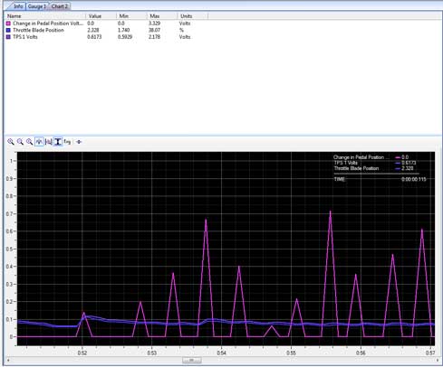

Finally, this shows how severe I can make it. This is me just pumping the throttle quickly......notice the pedal is being pressed over and over and over (pink spikes) but the throttle TPS nor the throttle body ever respond at all. Obviously I wouldn't normally drive like this, it was just a test for demonstration.
