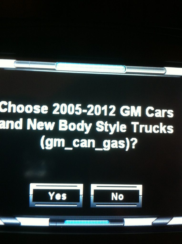

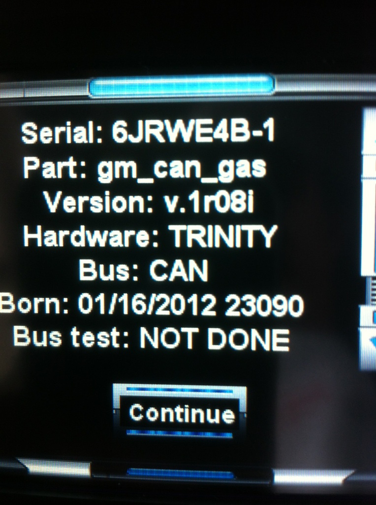

I have a 2007 Classic Silverado 2500hd....when i updated to 1r08i I cant find my vehicle all i see is 2007-2012 hd new body style....any ideas?
RE: Cant choose vehicle
and yes, I already had him update with the trinity_gm_j1850-1r08d_update.crom as well... and still no good....
any ideas Mike??
any ideas Mike??
here are the messages i am recieving....i am still showing the i update as you can see in the pics....but i have done the 1850 d update and it wont show up in the information screen
- IMG_2002.jpg (181.95 KiB) Viewed 2742 times
- IMG_0182.jpg (201.04 KiB) Viewed 2742 times
- IMG_8623.jpg (185.01 KiB) Viewed 2742 times
Well after calling Diablo... I was told to change vehicle to a anonymous vehicle then go back to info screen... New update was applied after that... Then was told to choose 2006 avalanche 6.0. Low and behold everything was ok after that.... I was able to install tune. Thanks to Lew and Vas... Now to work on the Diablew tune...

but it looks like he was selecting gm_can_gas06MonteSS wrote:and yes, I already had him update with the trinity_gm_j1850-1r08d_update.crom as well... and still no good....
any ideas Mike??
Maybe the 07 selection is not letting you choose classic/NBS?
I have to look...
RE: Re: RE: Cant choose vehicle
correct... there was no selection for classic or nbs for his 07 truck... he said instead he selected 06 avalanche with the 6L engine and it worked, heh...
