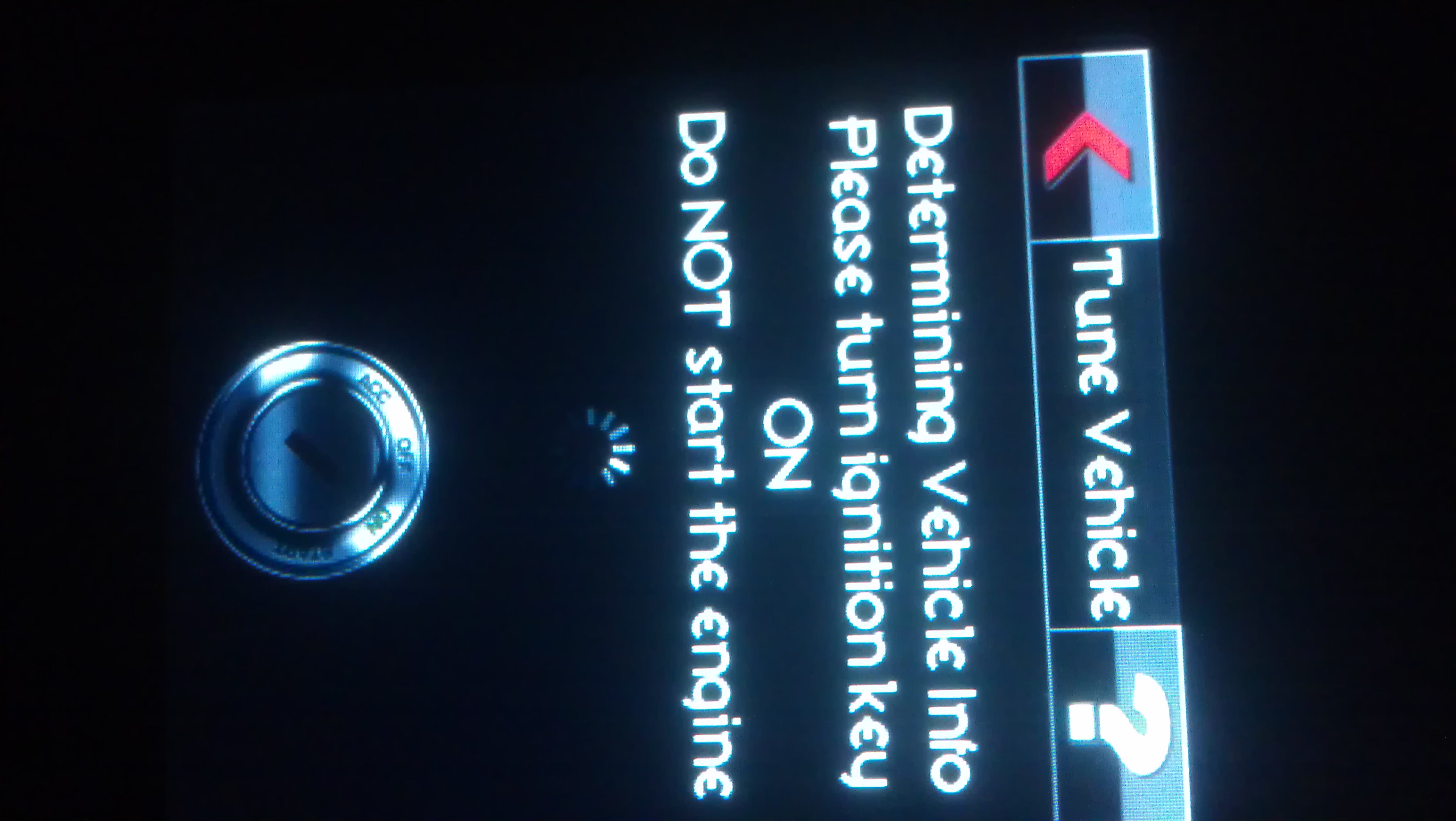

I Tried to connect my Intune to my jeep wrangler sport 2006, when i make press write vehicle it freezes as below pictures, everything else is working properly like DTC & Data Logging . Called Diablo Sport, made a reset for the intune,( coasted me around 15$, because am calling from Amman Jordan ), and it still freezes

- It freezes right here when I press Write vehicle :(

I called yesterday, made a reset for my intune, and Vas sent me a file on my email and IT WORKED
At Last.
Thank You DiabloSprot team for resolving my issue
