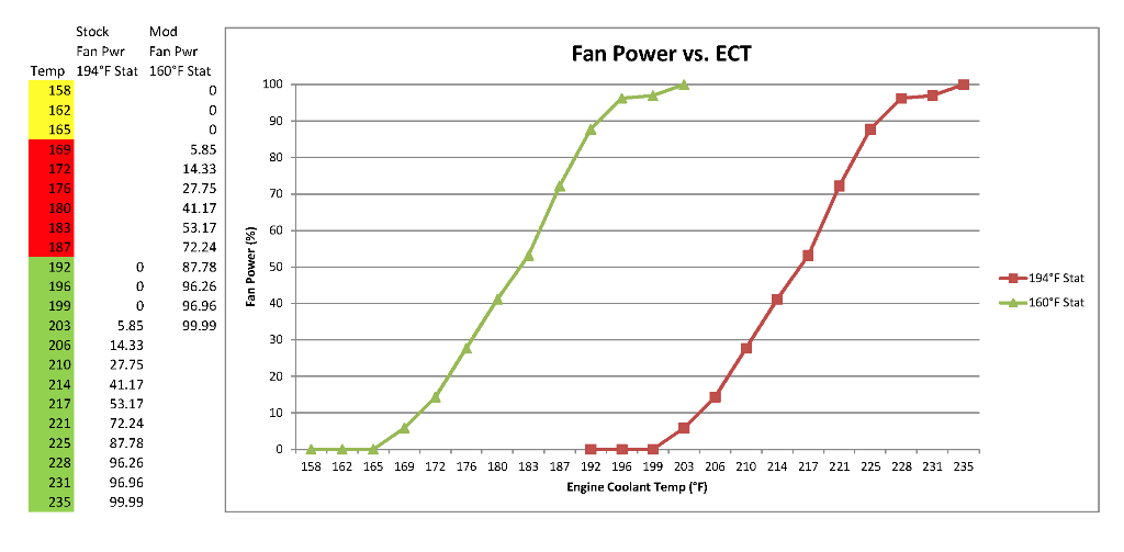

Ok so I started to put some more time into figuring this out.
I plotted the stock engine temperature vs. fan power settings in an excel chart and then extrapolates a temperature shift for the popular 160F stat.
The stock thermostat is 194F and the common replacement is 160F thus a 34F shift cooler.
Fan vs. Temp Chart sm.png (52.7 KiB) Viewed 4064 times
The problem that I see is that the lowest temperature that we can adjust the fans to turn on is 192F. Per the chart this would mean that the fans would have to start at 87.78% fan power.
My request would be, if possible, to add at least 6-9 more temperature setting points below 192F.
In my opinion anything less would make the adjustment settings in the Trinity very limited if not useless.
Mike et al, Can it be done?

problem is, the factory PCM only has the cells present down to 192*....not much more that can be done there...

Jesse on Cadillac Forums indicated that the entire map had to be re-flashed to map below 192F. I gather that's more that you guys want to do..... it would sure be nice if the adjustment option you're selling had a functional use.....

Thats not an option with a tuner like this. To reflash it like that, they really need the computer in front of them, which many people don't want to do, hence the functionality of the tuner.

wetcoast wrote:Jesse on Cadillac Forums indicated that the entire map had to be re-flashed to map below 192F. I gather that's more that you guys want to do..... it would sure be nice if the adjustment option you're selling had a functional use.....
to do so requires a custom operating system, since your doing something beyond what they designed into the pcm code. We are not big into rewriting the operating system when GM did a pretty good job to start :)
