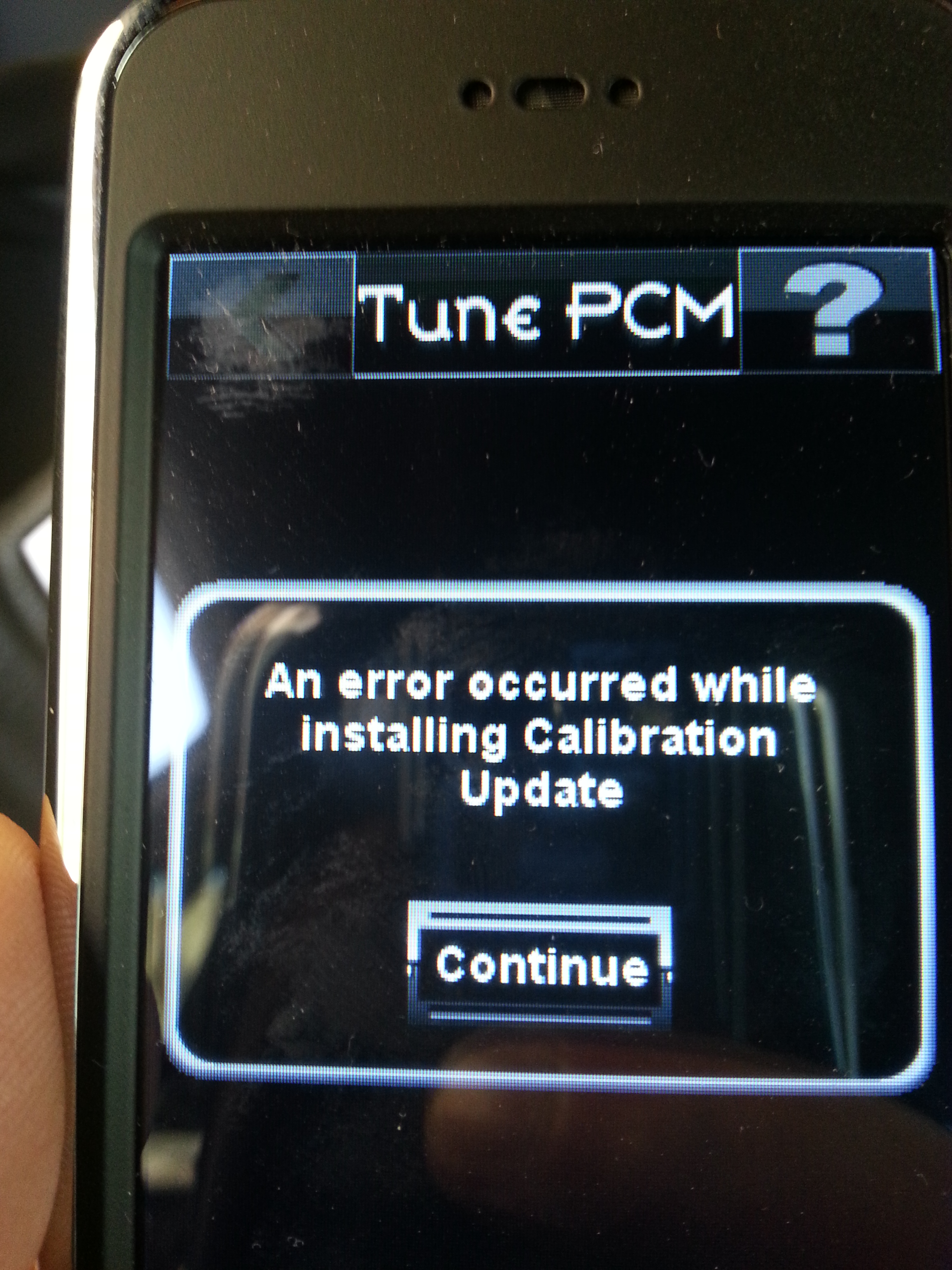

i connected the intune to the vehicle went to install calibration update. Got to 99%, and asked to do a key cycle. Key off, press green check mark. Fine. Key on (no dash lights came on btw when i turned key on), pressed green check mark. Tool tells me "an error occured loading calibration tune." Dash lights then come back on. Tool recycles and is in recovery mode. Wants to only write calibration tune at this point. Tried about 5-6 times and exact same results
engine light is on after this issue.
intune now is stuck in recovery mode ..... the car failed to be tuned
Plz help... Or if there is any way to tune the vehicle with any firmware for the time bean.

please give us a call with the tool powered up in the car.

the dcx tool will not work on a 2010.
Re: 2010 SRT8 challenger 6 speed intune issue
Thanks Mike for your assistance the issue has been resolved after swapping the tuner .
