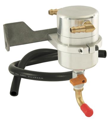

I already told you about the CTS-V getting oil in it a while ago, and now I pulled the TB on the Yukon and guess what? Oil in the mani again! Gotta expand the catch can line to LS motors. If Billet Tech doesn't want to do it for you, I'm sure there are other companies who do. :normal:
This is with just 5600 miles. :blowup:
Oil on the flange.
Tons of carbon in the mani with a coating of oil on the bottom.

the only thing application specific about our cans is the bracket and hose lengths...it will work fine :)
I know you could find a good way to mount it ;)
I have been pushing to make a universal catch can part number, and just include no bracket and the longest hoses available....

Anyway, Whats the price on that? I found a Moroso Catch can for the Vortec trucks. P/N 85481, runs $140-150.
