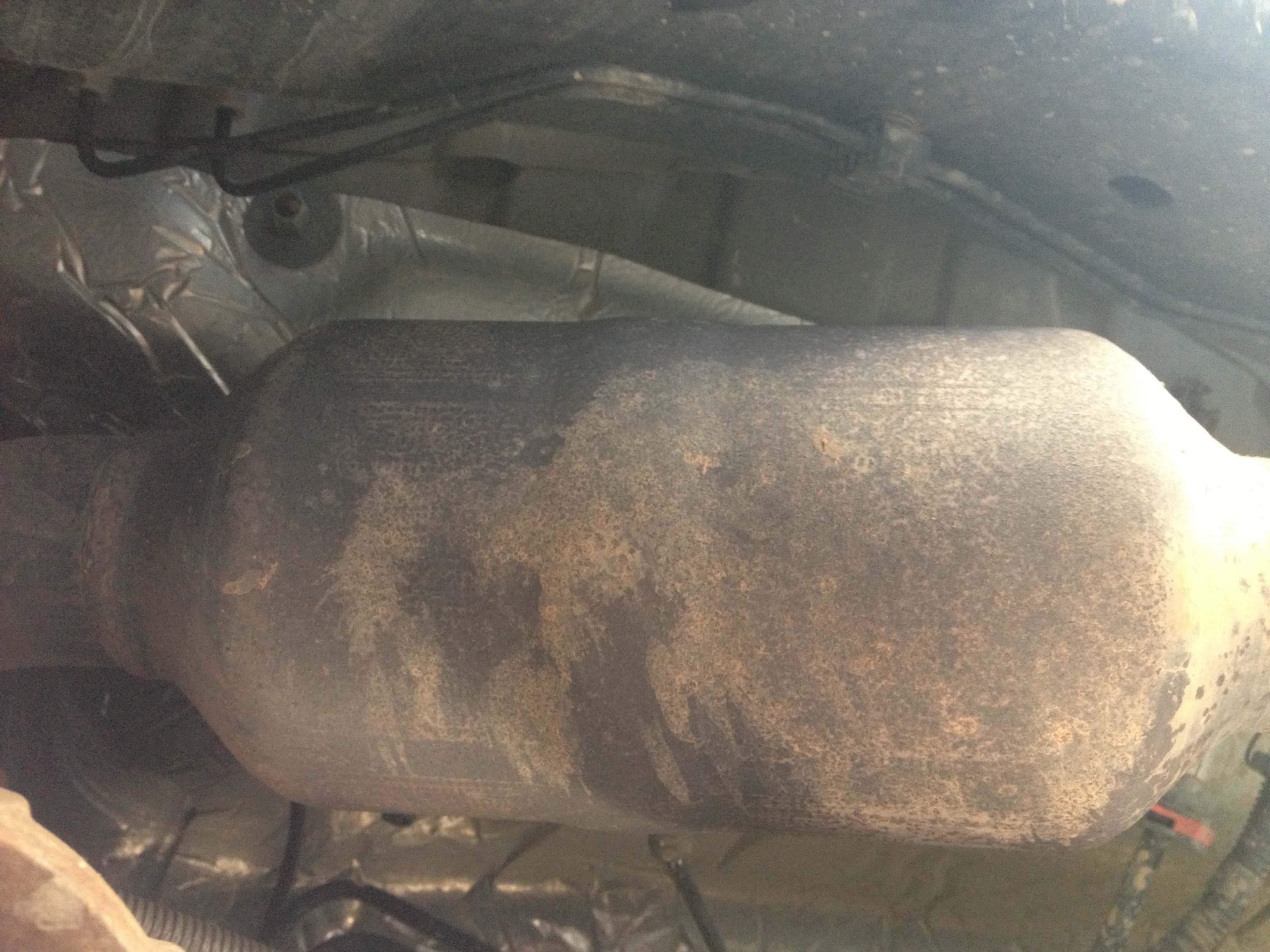

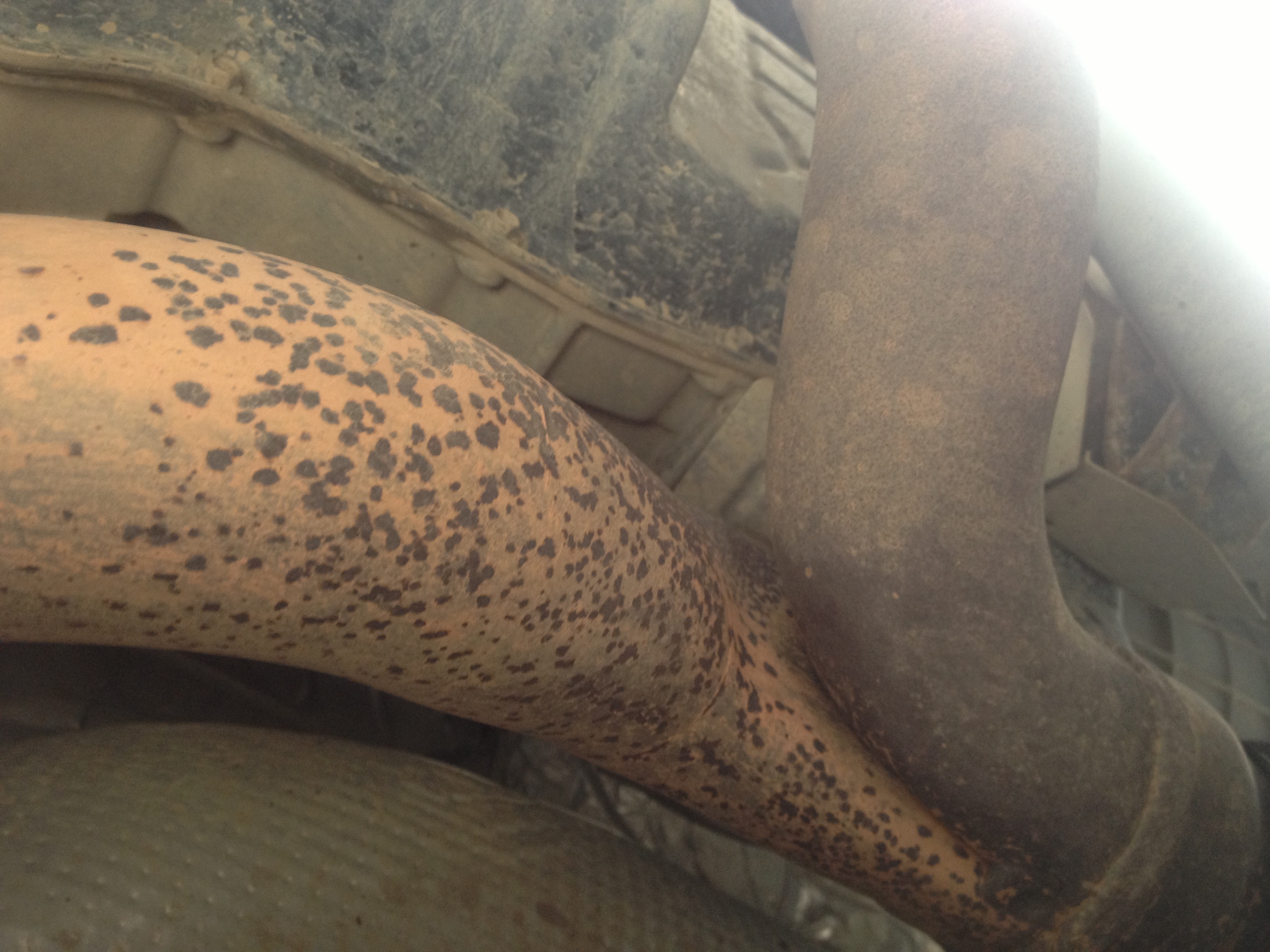

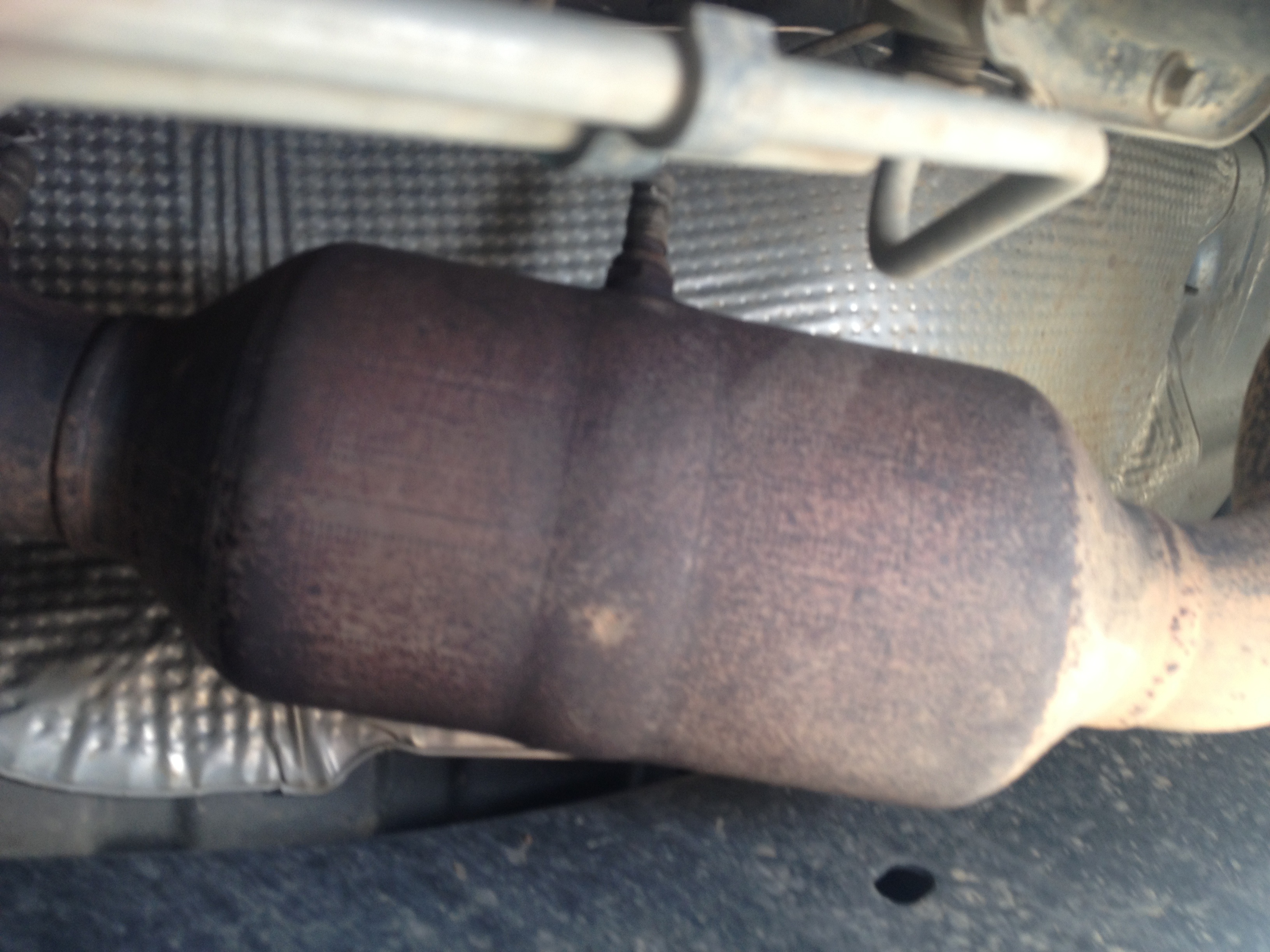

Crawled underneath unplugged both sensors no sign of corrosion in connectors, no melted wires but i did notice a difference in catalytic convertor coloration one looks like its running hotter then the other. Heres a pic. Btw i have mds disabled so it shouldnt have anything to do with that. Heres a pic of where the exhaust joins both cats are same color as seen in difference in pic

That cat looks overheated. Could be clogged.
You wouldn't know if the knock was false by the exhaust sound. The ECU is gonna pull timing either way.

Whats normal cat inlet and outlet temps warmed up

Will probably replace them with high flows and replace o2s then cut apart and peak inside...then take a wait and see attitude...recommend any highflows? Edit: just read snow against a hot cat causes it to contract being i live in a snowy place it prolly contracted and fractured the cat... Will get both replaced with high flow and will prolly solve my problem

That passengers side cat looks bad.
