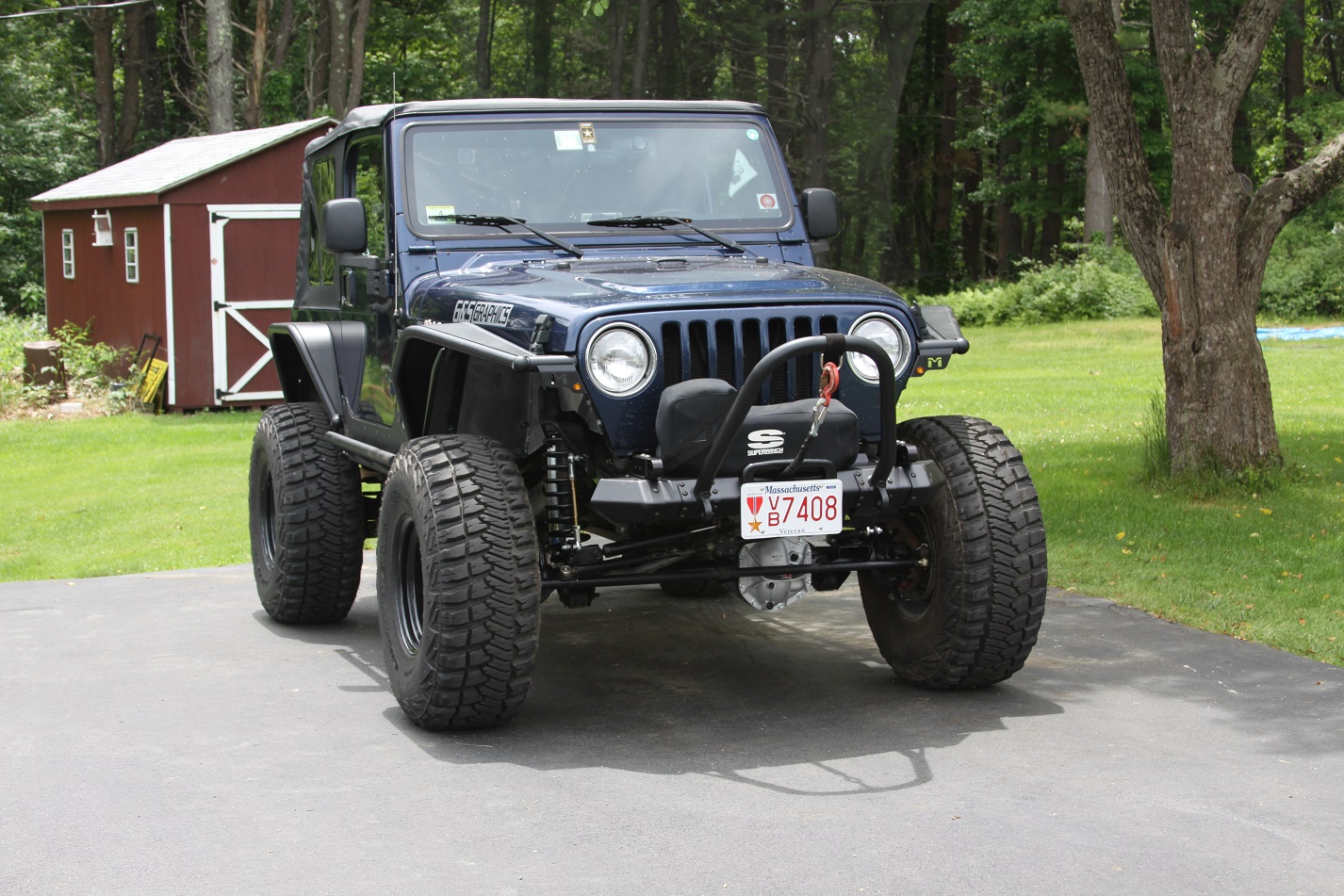

I just started using a Trinity. I have the 93 Octane tune in my 2005 Jeep TJ with 4.0 Auto. I like being able to bump the idle RPM up with the AC on. I use the full 400 rpm when in Drive with AC on. I use this on the trail where I want to just crawl over something without hitting the accelerator. I would like to see this option brought up to 600 RPM for Jeeps. That would allow me to crawl larger obstacles without throttle input.
Here is a quick picture of my rig testing a Currie AntiRock sway bar.
Here it is at rest between wheeling trips.

by mikel
heres a tip/trick.
load the tune with the 400 rpm added to the idle.
grab the last tune written from the tunes folder/intune drive, and put it on your desktop, and rename it (add _custom to it), then save it back to the intune drive.
Now, load the custom tune to the Jeep, and when the tool asks, choose Yes to reset parameters, then go to the idle, and you can add up to 400 RPM on top of the 400 rpm already added in that tune :)

That's awesome, I'll have to give it a whirl. I think 600 will be about right up to 45 degree inclines, might need the 800 for ledges. It would really be nice to be able to change it on the fly, but I know you have to work within the constraints of the OBD stuff.
I am really impressed so far, I could actually feel the benefits in the seat of my pants after flashing the 93 Octane Performance tune. I am a long time Diablo user. I had a predator in my Mustang with a custom Tune for a Paxton Novi Blower. My Tune guy did great things with it on the Dyno. Might have to take the Jeep down to him and have him work some magic on it. Not sure if his dyno goes that low for HP hahaha ..
Thanks for the Tip !
