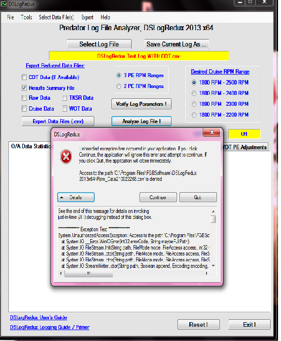

Re: Frank and Lew's GM Log Analyzer Available!
does this work with the intune? or has it not been updated to do so yet? im having trouble getting it to work with my 2001 sierra with the 4.8l. unsure if im doing something wrong or if its a compatability issue.
ok well ill attach a screen were you can see the error im getting even with the files that came with the program im getting the error.maybe someone could help looks like a very neat tool just need a lil tuning:p
