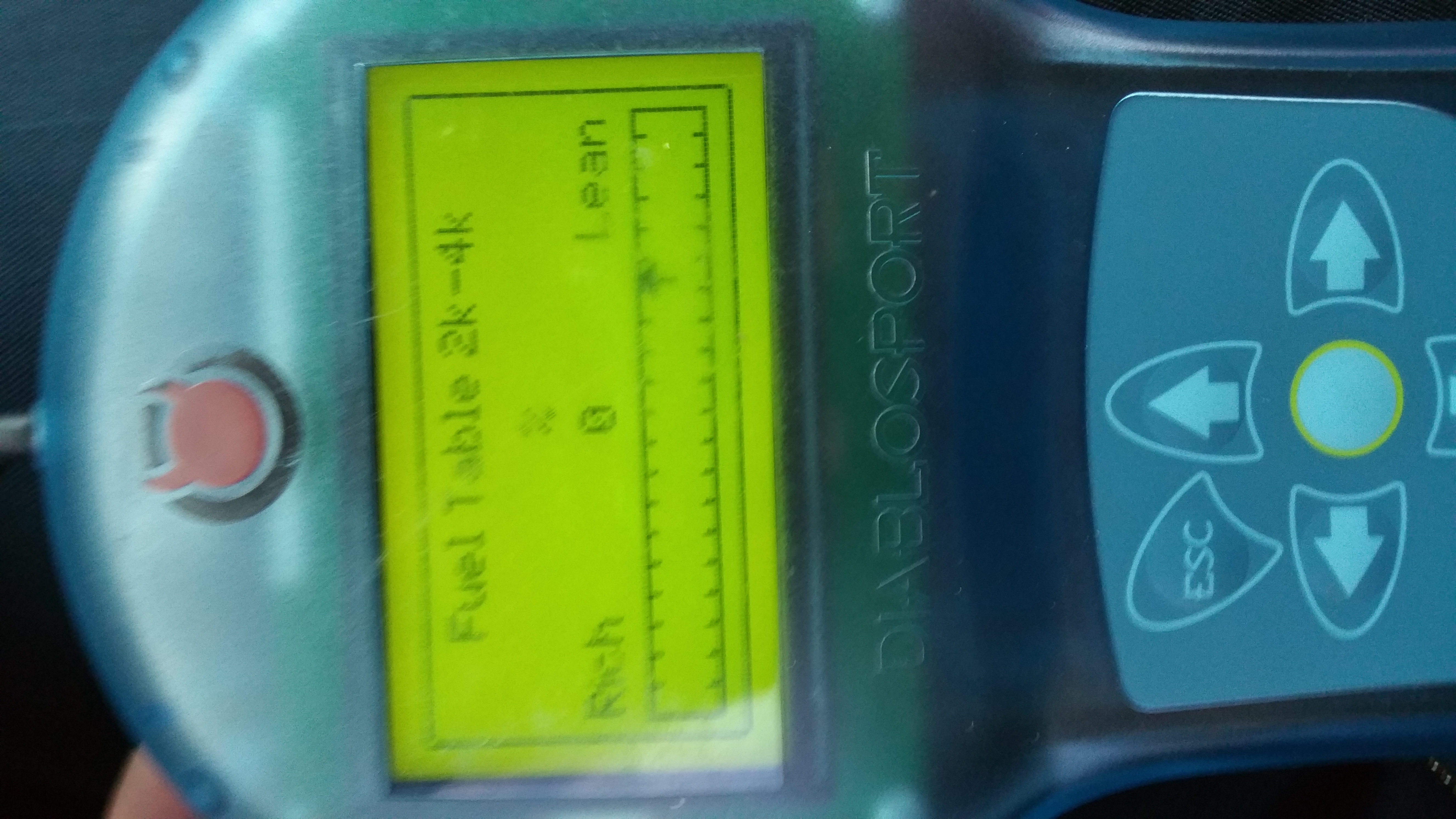

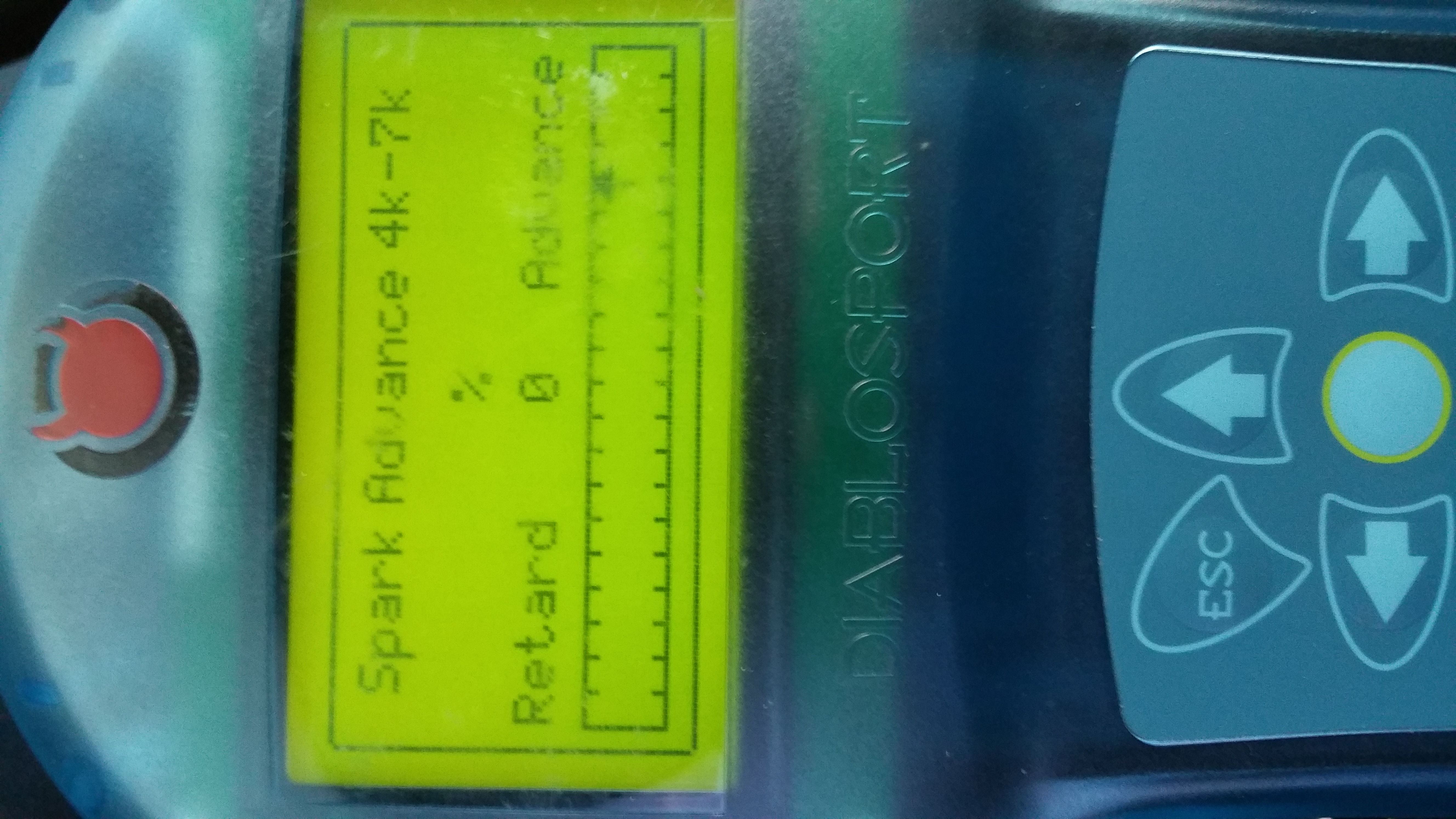

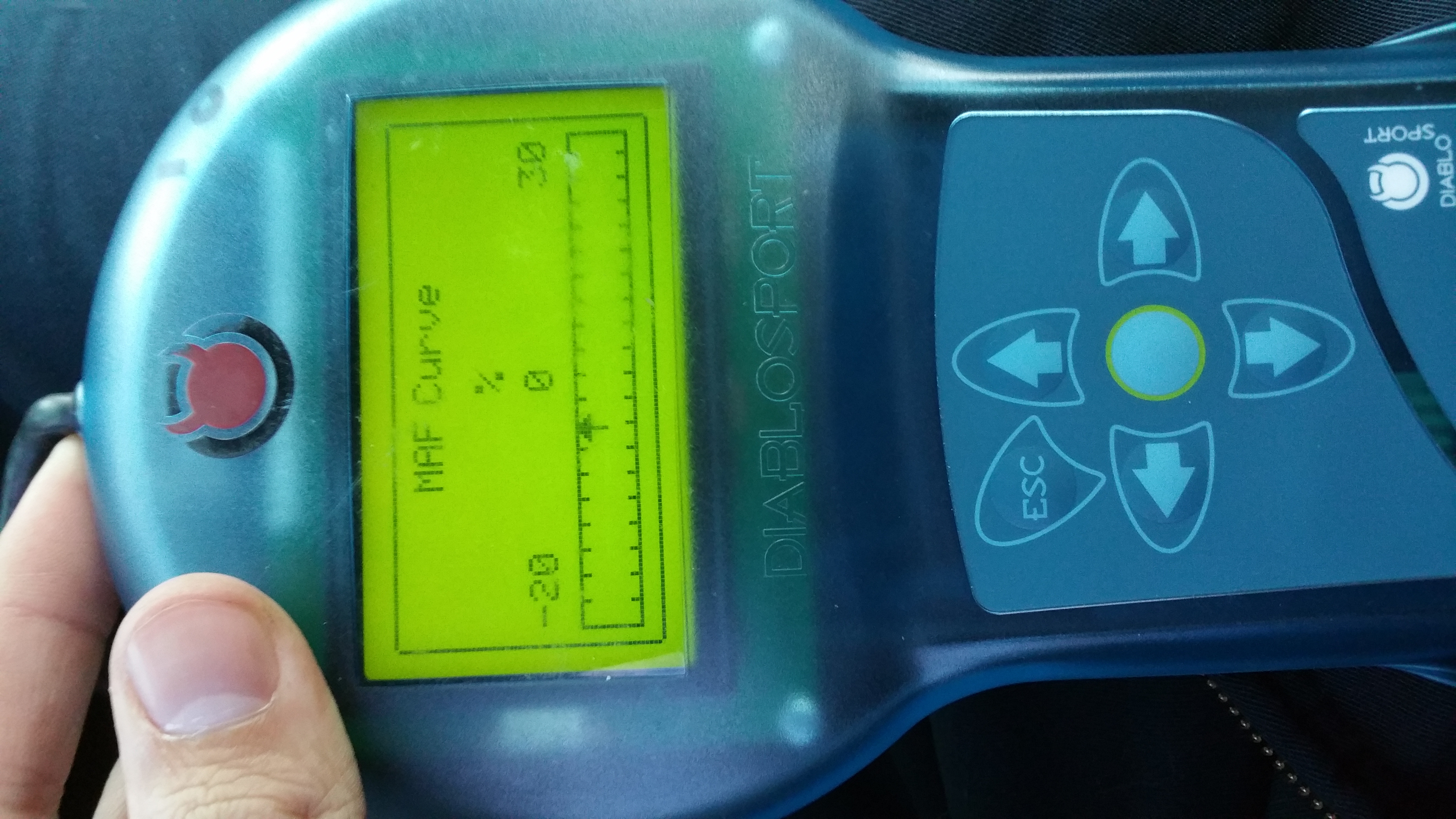

These are the settings in this tune. I did a data log and saw that my short and long terms don't seem right from what I was reading in how to tune. I was getting aroun . 8778 on trims.
- 20150105_162446.jpg (4.29 MiB) Viewed 5371 times
- 20150105_162236.jpg (4.46 MiB) Viewed 5371 times
- 20150105_162109.jpg (4.15 MiB) Viewed 5371 times
- 20150105_154846.jpg (4.46 MiB) Viewed 5371 times

At wide open I notice spark advance is down to 1-5 then slowly climbs the rpm band. To about 24. I think the tune really is the issue. I just threw a code again for 3rd cylinder misfire. I replaced the cop and plug. Still getting this Code. And the misfire. Think the timing and ratio of fuel is causing misfire?

Seems like under heady acceleration I get a huge drop in spark advance degrees and this bad timing could be causing the random misfire. Opinions, suggestions, HELP PLEASE

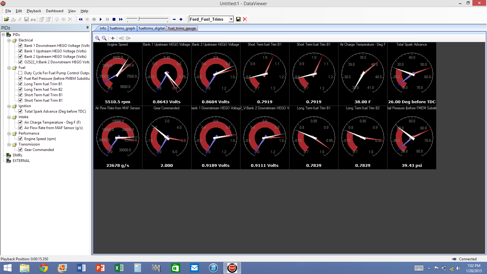

if my trims look like this do i need to go more rich or more lean? How does spark look?
