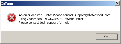

New owner here, just bought the intune today and updated it. When I plug into my Ford F150 it states that the calibration needs to be updated. I take it to my computer and I get the error attached. I have also attached my xml, please assist in anyway possible.

2010 F150?
What motor is it?

2010 Ford F150
4.6l v8
Thank You.

We're working on getting this added here shortly.

Very sorry for the delay, the update is attached here
FORD_TUNES-1t01xd.ITF
(15.51 MiB) Downloaded 335 times

save it to the intne drive and the tool will import it, then you may tune the truck.

This has fixed my issue. Thank you very much for your assistance.
