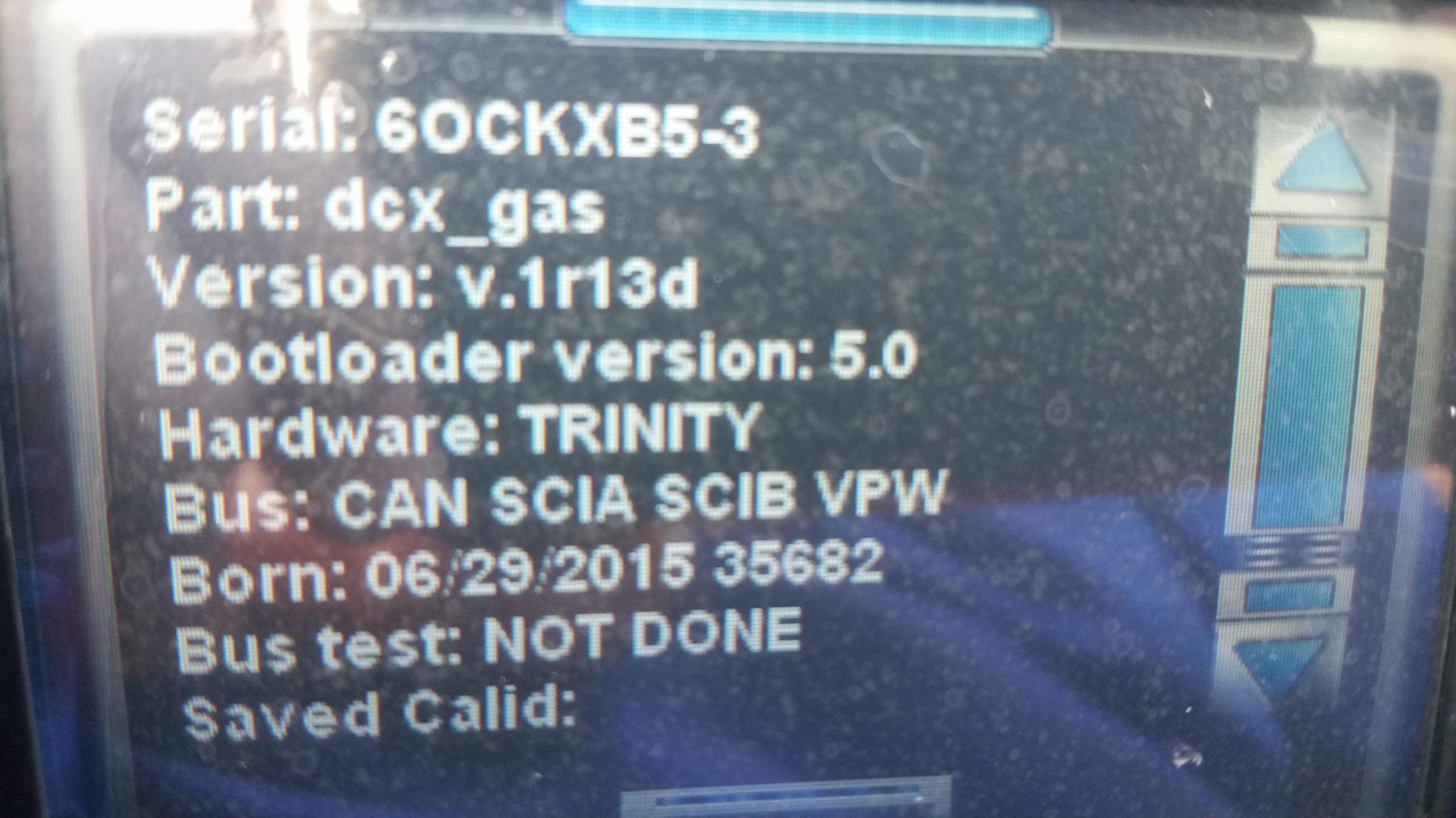

I have a 2014 Challenger RT manual transmission and a trinity 1000. When I try to connect the tuner and follow the instructions I always end up getting stopped buy an error message saying it cant communicate with unit 1. It will then try again 3 more times. After that it automatically shuts down and restarts. I have updated the trinity multiple times but I still haven't been able to get it to work. Is there something else I can do?

options/show information, whats the part and version?timcargo wrote:I have a 2014 Challenger RT manual transmission and a trinity 1000. When I try to connect the tuner and follow the instructions I always end up getting stopped buy an error message saying it cant communicate with unit 1. It will then try again 3 more times. After that it automatically shuts down and restarts. I have updated the trinity multiple times but I still haven't been able to get it to work. Is there something else I can do?
Re: 2014 Dodge Challenger Shaker R/T
The part is: dcx_gas
The version is: v.1r13d
- This is a picture of the screen
- 20150803_172240.jpg (4.2 MiB) Viewed 5242 times
removed the button and have the key in the RUN position?
Yeah I have tried that, I've tried every different way possible many times. is there anything else?
Have you tried calling in to see if we can go through it with you?
Maybe try it in another vehicle to see if it communicates properly there?
