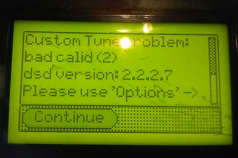

your "test" file got me this error (see attached photo), I assume you go to "performance tune" menu on device and it will search for a custom tune file?, when you go to "custom tune" menu under "options" that seems to get me no where.... my car is an official "brick" , I tried calling your customer support last friday and they (Mike M.) told me its my tuners problem and my tuner says since its a software download problem its diablos problem, here I am stuck in the middle with my pants down, the forum is eating too much time, cant we move this up a notch? a phone call perhaps?mikel wrote:please try loading the attached file through DSDL
- 20150810_180201.jpg (76.25 KiB) Viewed 7150 times

this has to be an issue with the old crom, please restore the stock tune, update the tool to this version, then delete all the files associated with the HEX named files, let the tool read a new backup,m and Mike at TSS or I can make the new tunes from that new backup.

I thought I had the latest CROM file installed but now realized i didnt, I followed your procedures and attached is the new generated original back up file. I loaded the performance 91 octane file to satisfy the device to create back up file to send you. Mike from TSS is on the road so if you can edit the custom tunes files and attach I would aprreciate it, TYmikel wrote:this has to be an issue with the old crom, please restore the stock tune, update the tool to this version, then delete all the files associated with the HEX named files, let the tool read a new backup,m and Mike at TSS or I can make the new tunes from that new backup.
