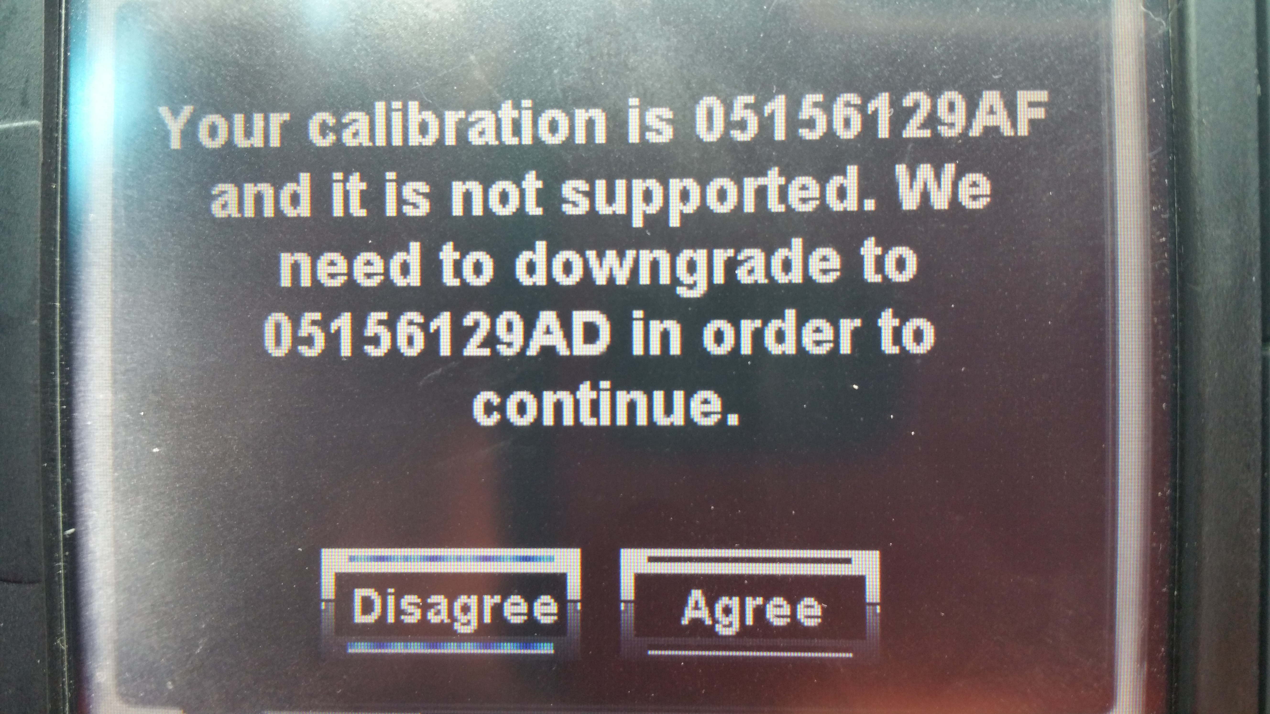

I have had this Trinity on 2 previous Rams and now on my 2012 challenger. I got the error about CAL ID Needs to be downgraded from 05156129AF to 05156129AD so I did programmed the stock 93 tune ran it for about a 2 weeks. Then I went to the dealership the other day to get some warranty work done so I did the usual which I have done for years. I restored and reset the tool. but then when you check your vehicle in they plug in a tablet to every cars ODB2 port and they pulled up a history and other stuff. My report showed they flashed the car and it needed a flash again they asked me if I did anything to it and I told them I just got it so no <wink>.
My question is when will 05156129AF be supported. I believe it was released to fix throwing of some code or something I don't know for sure. I am trying to avoid not having to get it flashed every time I go to the dealership and being asked my where the update went and why it was downloaded. Any help would be awesome really want to keep this tuner but if it comes to the tuner or keeping my warranty or fixing an issue with the car programming the tuner would have to go which I do not want to happen

will this update "trinity_dcx_gas-1r13e" fix the issue?

Nope!! left me on 05156129AD. Like i said in the Original post I don't really care other than 05156129AF fixed some TSB throwing codes and i got that damn sticker under my hood stating it was updated in January to 05156129AF. any ideas????

I'm in the same boat except I have a CALID that ends in AH for my 14 Ram 1500. Any idea when we'll see an update to support the new CALIDs?

They can't update the tunes until FCA releases the Cals to the public. Actually, I don't even know if they still release them since the 2011 encryption bullshit, so DS may need to get a PCM with them and reverse engineer them.

Then will downgrading mess with any safety recall programing (just got done today and did a pcm update) and when the updates do become available to diablosport will I have to go back to the dealer for a reflash for the pcm update or will the new tune files from diablosport reflash my pcm?

Thats the issue im having everytime. i go to the dealership they upgrade the cal id to clear up a TSB issue for throwing codes and such and when i leave i have to downgrade the cal id and lose whatever they upgraded. im sure they are upgrading for a reason.. it looks like they are 2 revs. ahead of Diablo if they go to 3 i may just have to abandon my trinity all together. which will be sad i have had a Diablo of some sort for at least 7yrs

I am getting he same thing ( just got my T1000) and have not had much time to fool with it. butt getting same msg. I have done the updates and still getting same msg. so is this thing only good as a gauge now?

Same problem here 2013 Charger R/T AWD.
