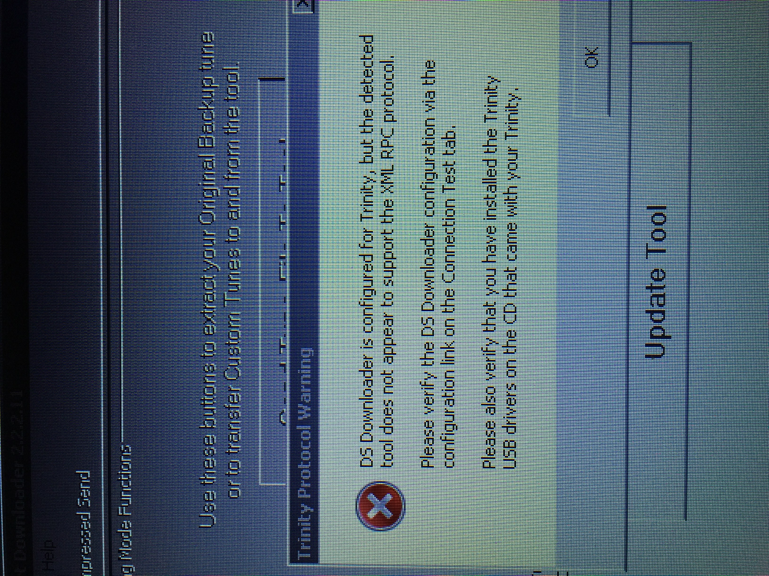

Trinity won't boot up after updating to the newest drivers and Downloader below.
DS Downloader 08-13-2015 2.2.2.11 DSDownloader_Installer_2.2.2.11.exe
DiabloSport USB Driver 08-13-2015 2.3 Diablosport_USB_Driver_Installer_2.3.exe
It kept hanging up and now when I plug it in just the red light turns on but does not cycle the other lights and it won't boot up.
This was in Windows10.
I tried using the original PC with Windows7 and it still won't boot up. Is there a way I can download the previous Loader and Driver?
Thank you.

hold the left button down and apply USB and continue holding it while it boots up then connect dsdl and let it auto update from the vehicle selection menu.

mikel wrote:hold the left button down and apply USB and continue holding it while it boots up then connect dsdl and let it auto update from the vehicle selection menu.
That appears to have done the trick. I will install the tune when I get home. Thank you for your prompt response.
