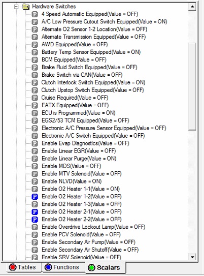

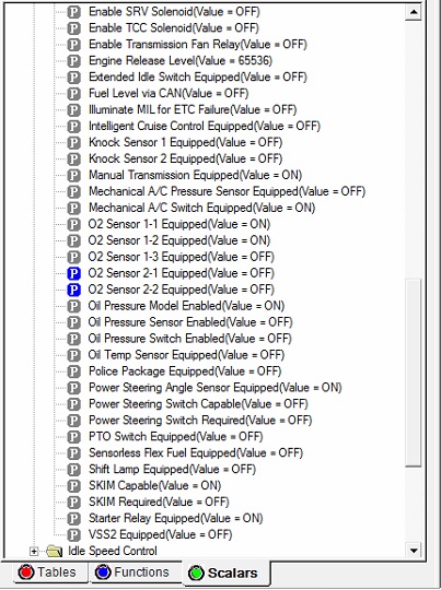

Re: Jeep Wrangler Supercharged 2005 - How to disable P2074
Hi Mike!!
Thanks for you help here!!
I went in the HW Switches and here is a list of what I see. I cant see anything related to the P2074 or something similar...
Let me know what you think!
- hwswitches2.jpg (112.64 KiB) Viewed 24108 times
- hwswitches1.jpg (109.47 KiB) Viewed 24108 times

- Posts: 58771
its in the first screenshot, SRV solenoid...
hmm, maybe not, it says its disabled, post the file
