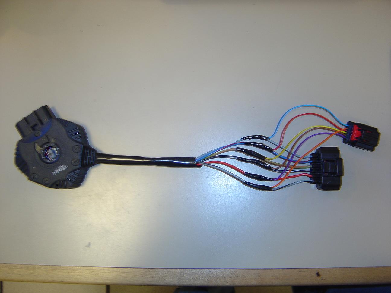

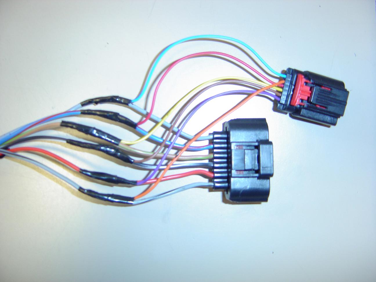

I took a few pics of some Mafia connectors and gave a little rundown on the pinouts. This is very helpful when using the mafia in special applications where you need to change the connector to a different style. ConnectorPin#.jpg is the most helpful with full definition of connector pinouts. The other two are for those who like pictures. You can make it out from the pics where each wire goes when swapping connectors. That is a universal tester I made for our flowbench and not something that would be needed on a normal vehicle. Warranty will likely be void when making these mods. I don't call those shots but I get a lot of requests for this information.
