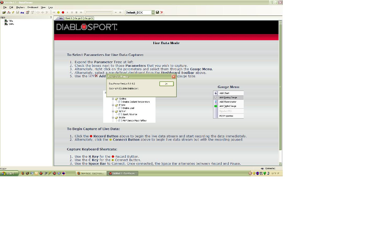

SS

3.1.6.2 is the latest version. You are using 3.1.5.10. You should upgrade that first.
As for your screen shot above, click on View -> Show Vehicle Information and give me a screen shot of that dialog.

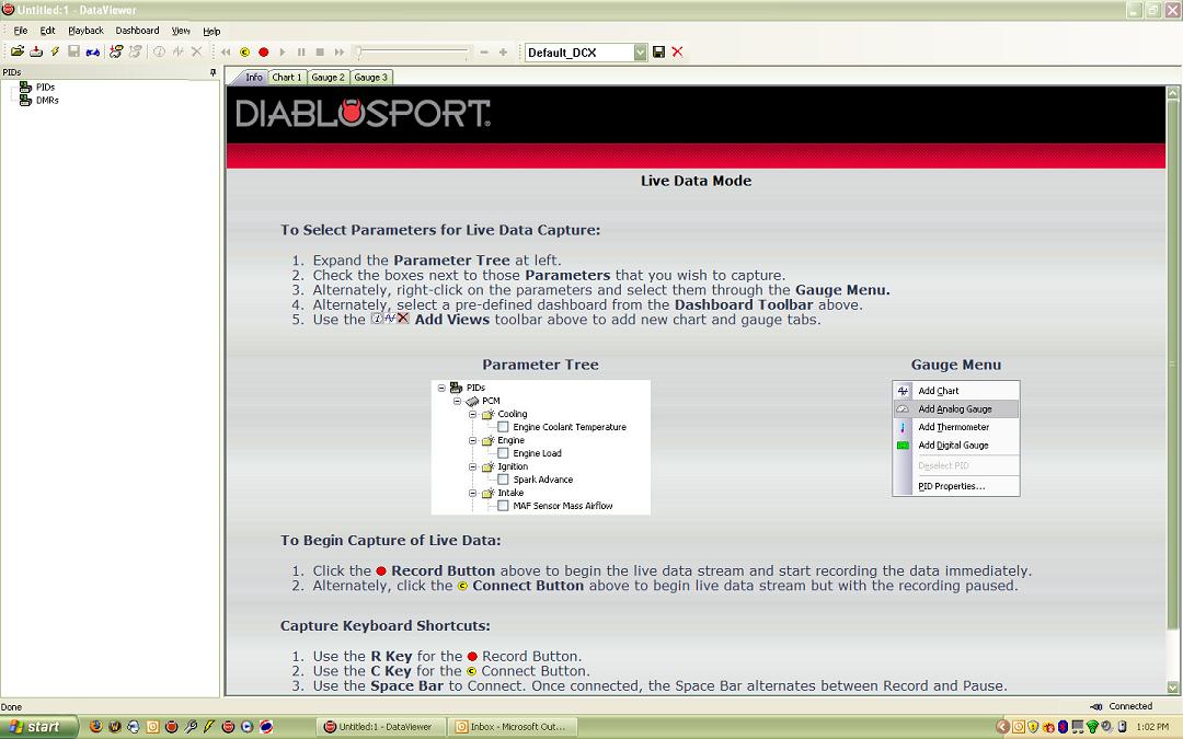

No Good same problem.
DW_new version.JPG (108.38 KiB) Viewed 4511 times

If you didn't already, please click on the blue vehicle button to rescan your PIDs.
johnc <at> diablosport.com
